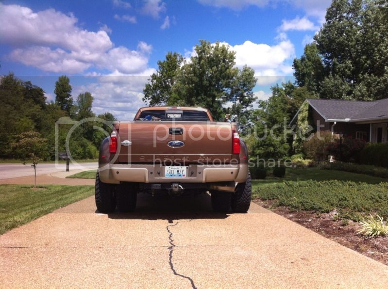

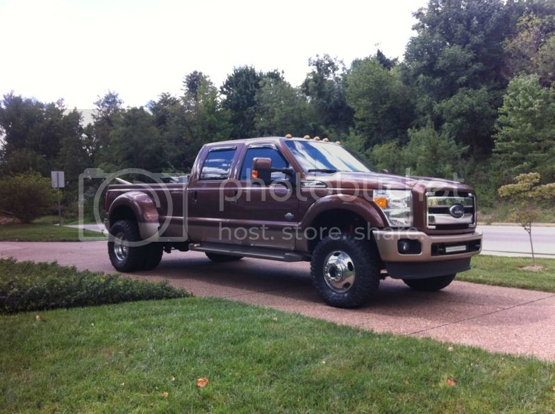

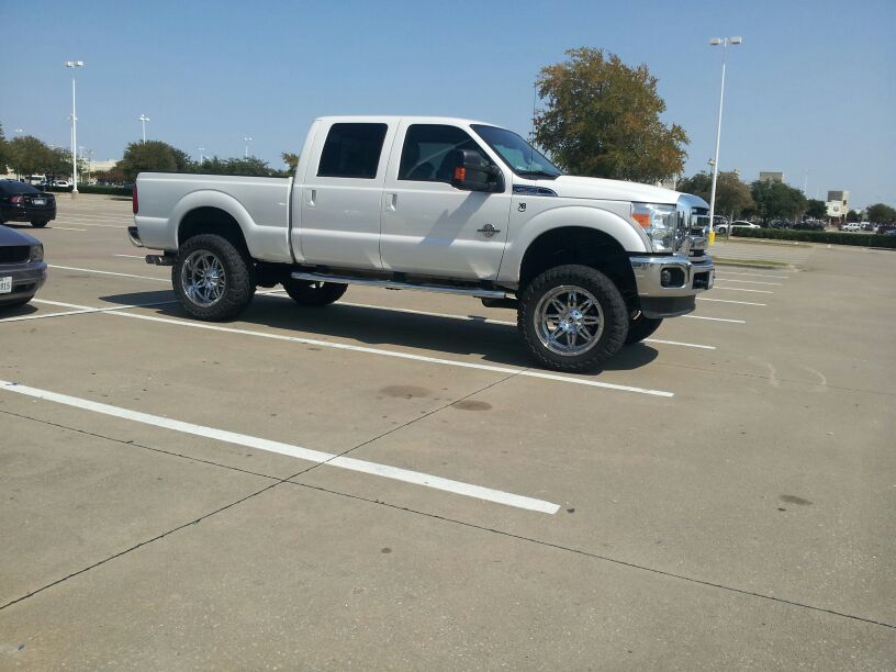

Hopefully ill have pics up of the dually tonight. Put a 2.5 inch leveling kit on it last weekend getting dual stabalizers, a 4inch rear block, and 34/11.5's today!

2.5 inch ready lift, 3inch rear block( going to go with a 4 just needa pick up longer ubolts)

Looks good like it is 03f3507.3 but the 4" spacer will look better. I like a little rake.

Yeah we tried to do the 4inch block but since My truck has the camper package with the overload springs the ubolts were about an inch short. So I had to order longer ubolts. Ill get updated pics when we change it out.
Is it a 3inch block total or an additional 3 inch block with the stock one? What size tires do you have? I just traded my white 11 F450 for a black 12 F450 and am looking to lift/level it and am having tough time finding a kit that will work!

3inch total, truck had factory 2inch and when leveled sat low in rear. 3 has it close but going with the 4 to give it a slight rake so its close to level with towing. Tires are 34/11.5/17 wanted to go 35/12.5 but didnt want the center of the tire to have an extreme creast to it.

Are you running spacers on the duals? Your truck stance is exactly what I'm after, looks great!
