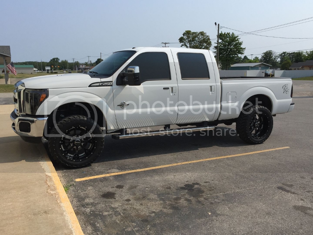

Yep got 35/12.5/r22 on 22x10.5 -25mm offset. Lift is a 2.5" level with a 4" block. Had to do a little trimming but no rubbing now.

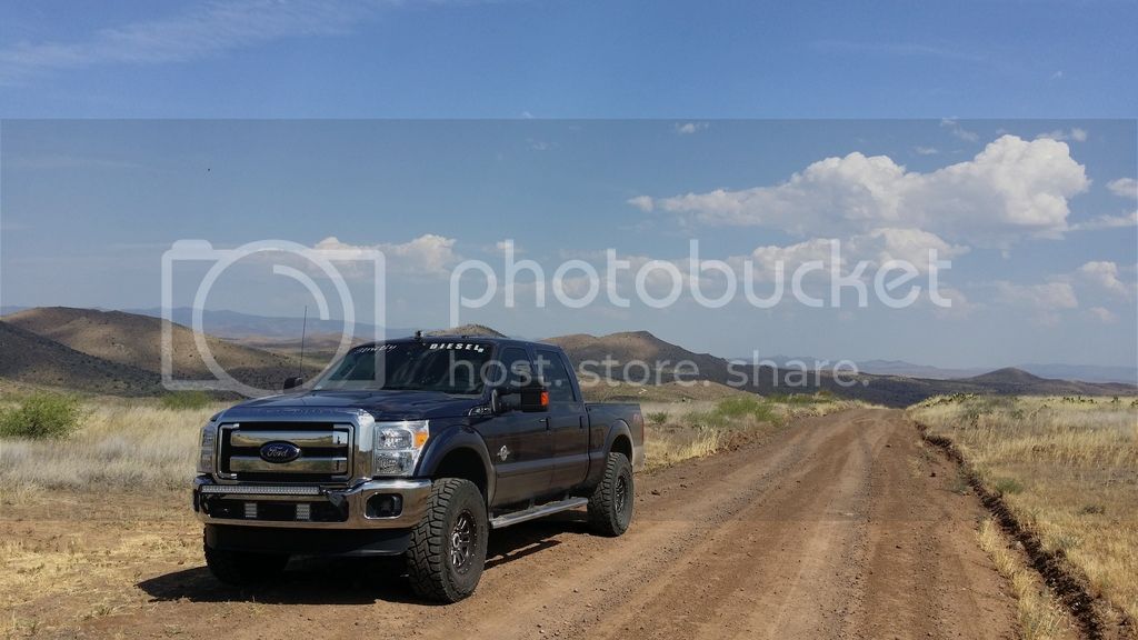

17x9 raceline clutch. 5.5in backspace.
Just don't run a tire wider than 12.5...
Tires are 37x12.5x17 toyo RTs

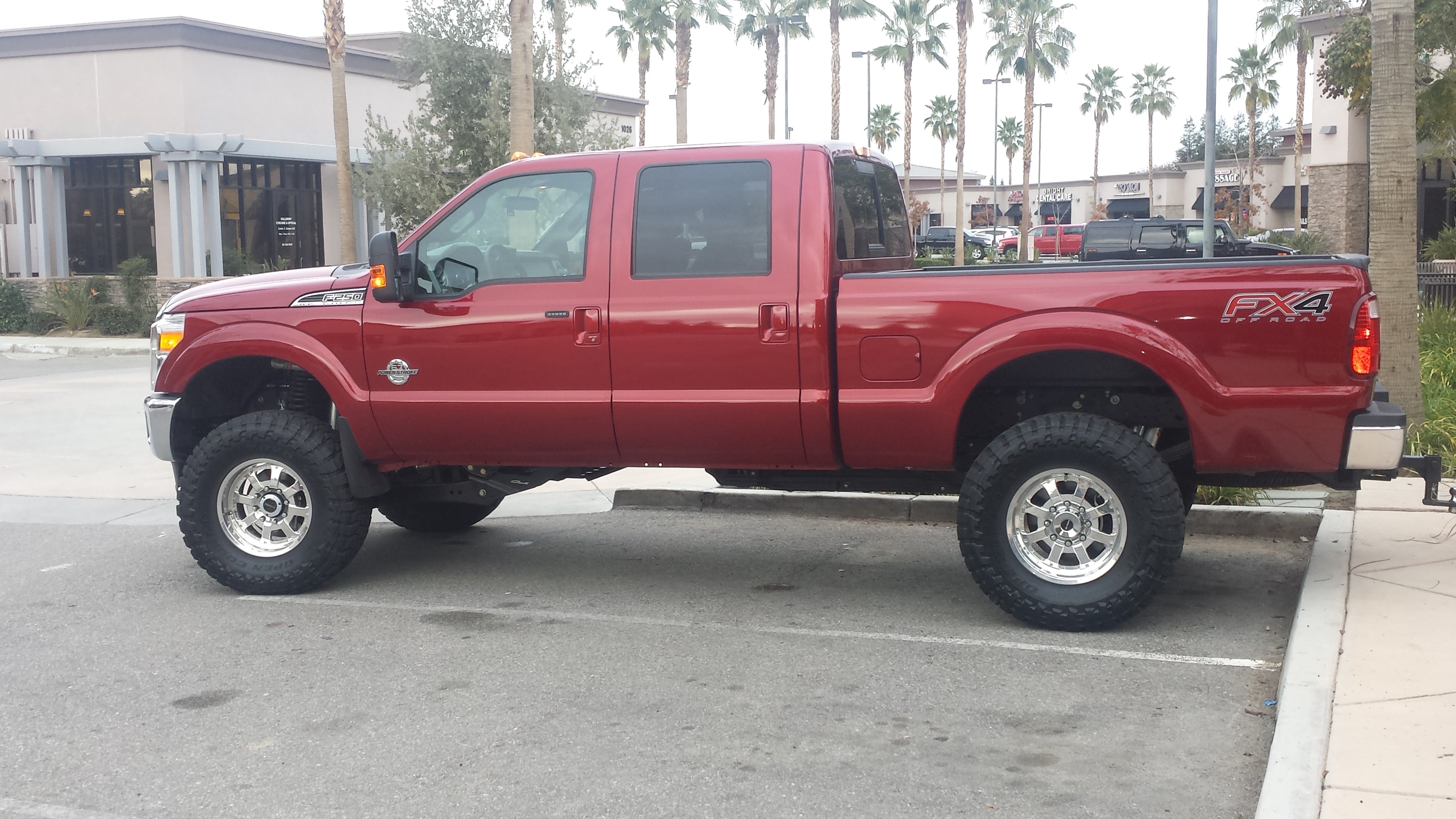

37's will fit with the right wheel offset.
Jomax and I are both running Carli 4.5" suspensions!
37x13.50 MT 18" wheel 5.25 BS Centerlines

I'm actually running their 2.5in lift with 37s.. and it still fits!

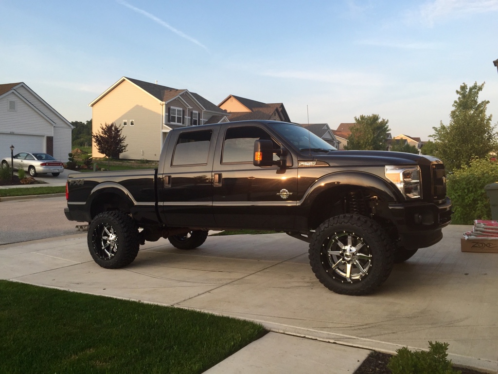

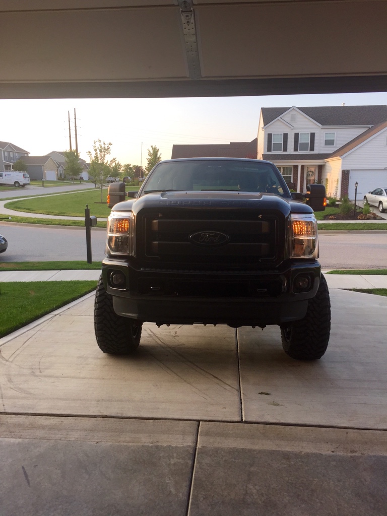

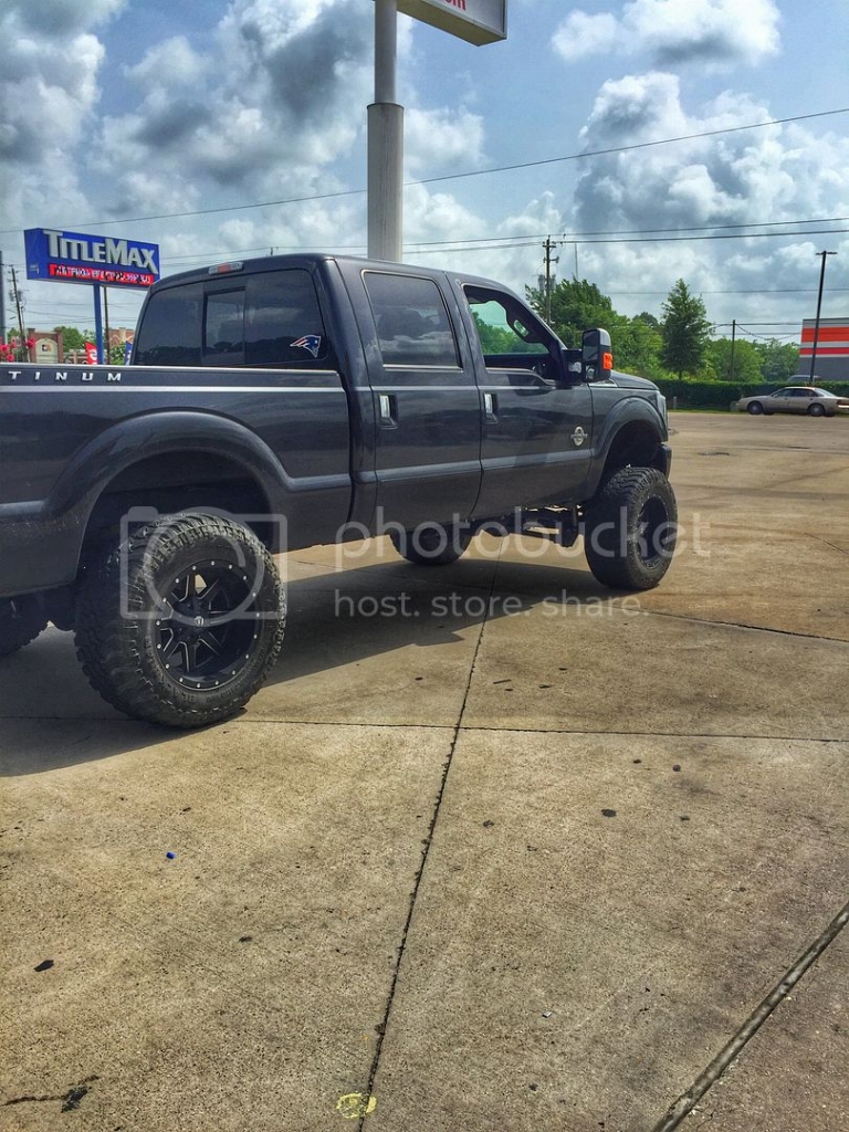

Just got done with mine today. Super happy with how everything turned out.
Zone 6" lift with nitro shocks and zone dual steering stabilizer. 22x12 -44 mavericks on 37x13.50 toyos. The bumpers and grill/ford emblem are vinyl wrapped with 3m g212 gloss black metallic. The center bars are brushed black metallic. Did the vinyl myself, it's a complete bitch. Tonight I'll toss on a 2wd valance, t-Rex lower grill insert and I'll try to finish up my recons that I took apart to redo. I'll toss up a few more pics when I'm actually done with everything.
