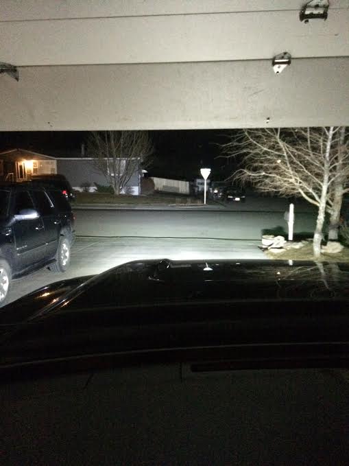

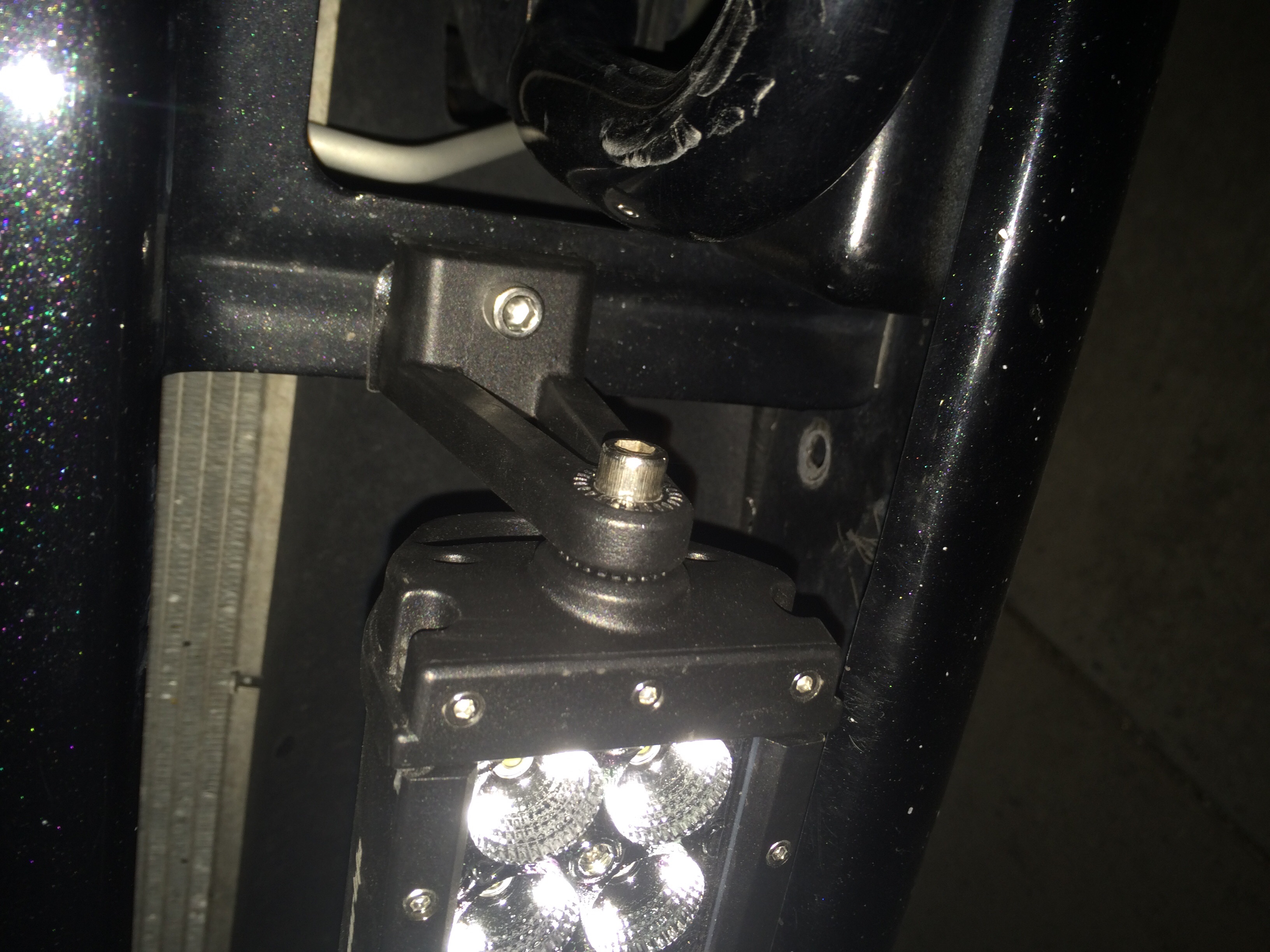

i ordered the 28" curved bar off of ebay should be here friday il let u guys know how it is
Raptorgabe
Jun 6, 2014
447
this is the curved bar that is on ebay for 89 bucks !!
