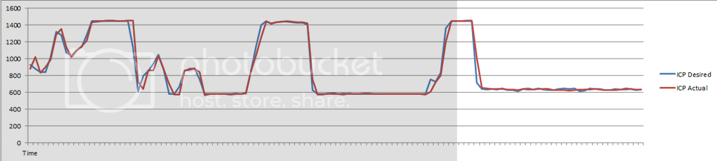

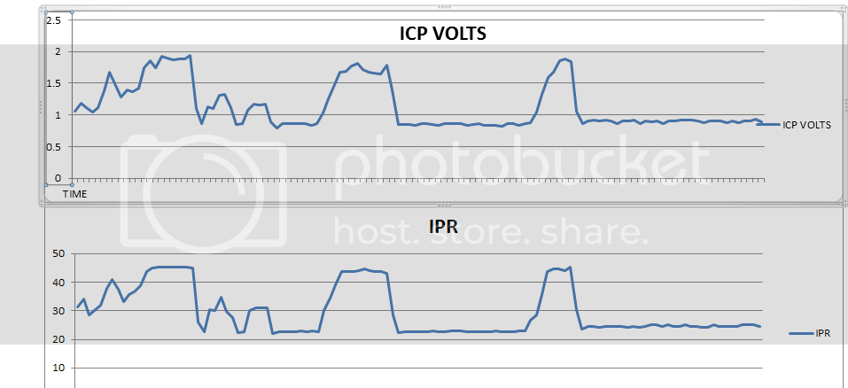

OK well trying to upload a data log was Fing Terrible. I had to import it to Excel, then make a graph, print screen, crop out the extra, save as a picture and upload to photobucket to post on here.
But as you can see ICP was limited to 2.0V, IPR only got to 44% at WOT. So really wonder if it is a sensor or HPOP. I will be picking up a ICP sensor tomorrow to swap out and try, oreily's says it has a lifetime warranty on their sensor so that's good. I will post back on Tuesday the details.

Can you read icp desired? Your ipr should be higher than 44% if pcm was calling for icp to be much higher than it is

Yes when i get home tomorrow night i can post up ICP Desired and IPR, ICP.
I data Logged ICP V, ICP #, IPR, and ICP Desired so i will graph them and get them up for you to look at tomorrow night i should have a new sensor waiting so i might just try that first.

Your icp and icp desired look like they are pretty close. You can change sensors till your blue in the face, if icp matches desired it's not gonna make a difference. How much boost are you building? What is your fuel pressure? You have the icp the pcm is calling for so that's not your issue

The ipr is not a sensor. if your icp matches icp desired and your ipr is only 44% you do not have a hpo problem. As I said before, you have the icp the pcm is calling for

How do you know your getting 50% fuel? What is your ebp koeo and while it lacks power?

Correct me if I am wrong but I know with a Ficm tune you can't read ICP pressure as it will flatline at 1500 your only real Indication of Icp is by voltage. Now the ICP pressure is what runs the injector and a wot run you should get 4.0V or roughly 4000psi. Now if I am running up a hill and go WOT I barely move and only hit 2.0V max. So by the voltage and seat of the pants I feel I am only getting 1/2 the power.
EBP I can take a look at tomorrow.
