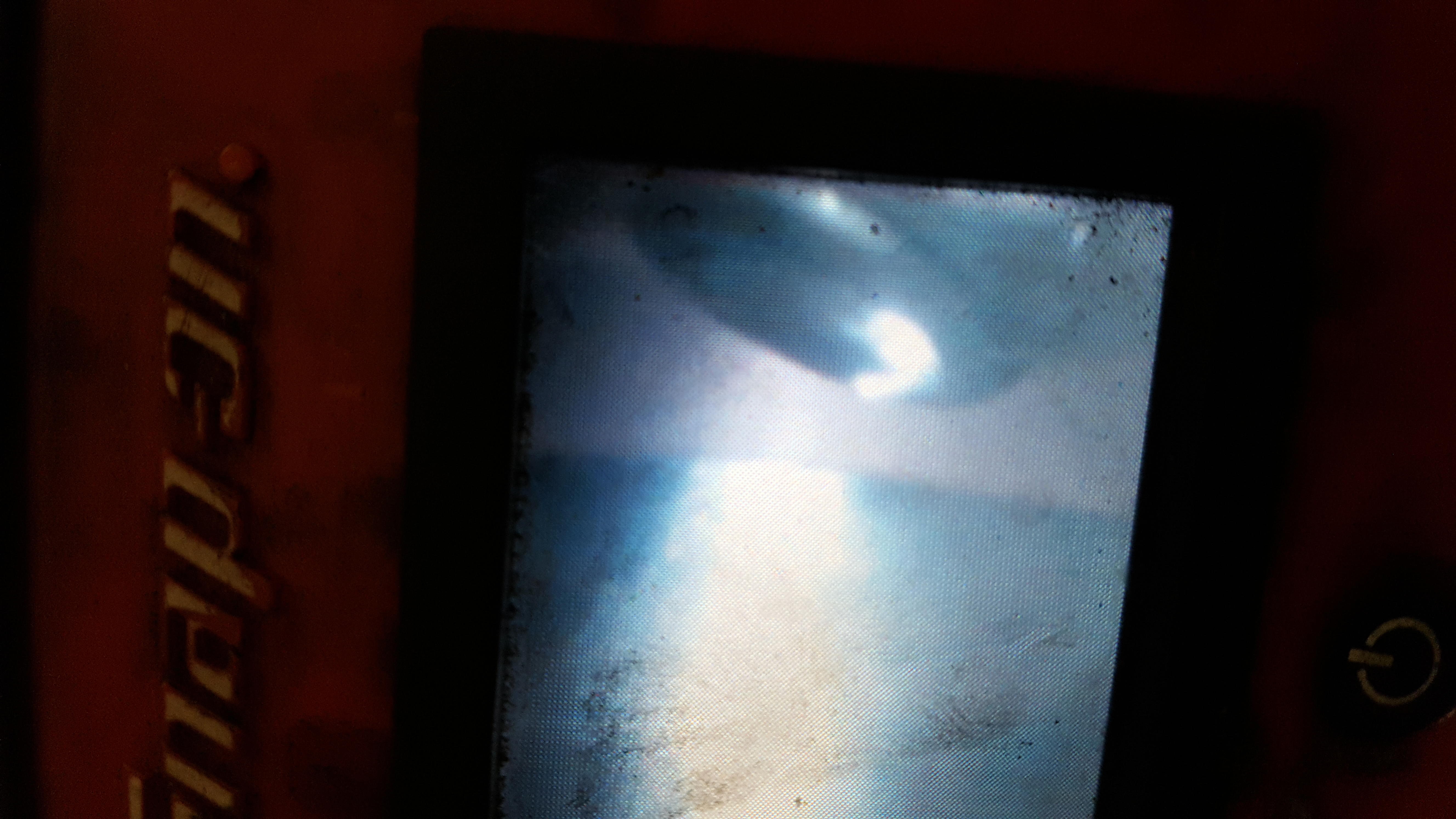

So I got around to pulling the head off to see what's going on. #1 cyl exhaust lifter came right out of the block, the lifter for the intake wouldn't come out. After poking around with a boroscope I find the pin that holds the roller on has backed out stopping the lifter from coming out. My father and I tried for a while to push the pin back in but we had to call it quits for the night. The exhaust lifters pin is also loose and moves left and right.
