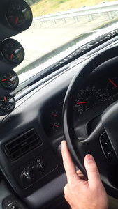

I still would say this may be a good idea, but I tried doing 5/8 line from a sump, to the 10 micron filter and my pressure still drops. I'm planning on adding a second pump eventually.
