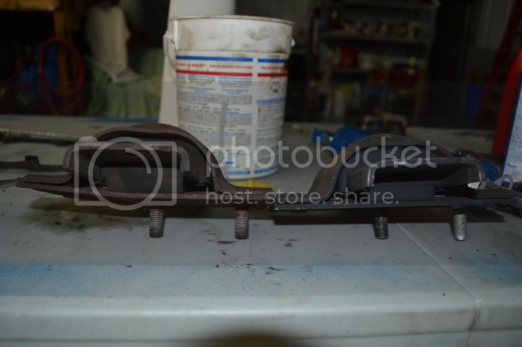

The driver side motor mount on mine pulled apart. The OEM mounts are obsolete from Ford but Vintage Parts bought the old stock from Ford. You have to know the part number in order from Vintage. I have the part numbers home.

Call your local Dealer's parts dept and they can look up the part numbers and order the mounts from Vintage Parts for you to pick up at the dealership. I called and got the part number from my local dealer and their price to order the mounts. I took the part numbers the dealership gave me and ordered direct from Vintage Parts myself. Saved me $3.00. The dealerships get a discounted price from Vintage that average consumer's don't. Had I known that I'd of bought local instead.
