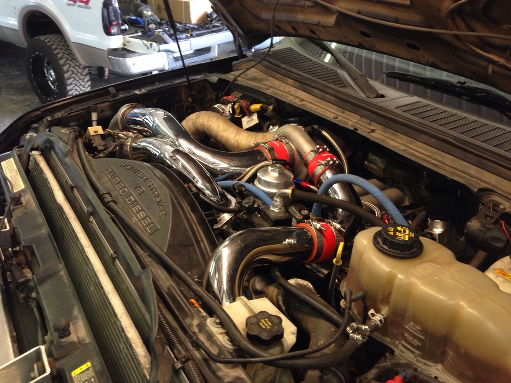

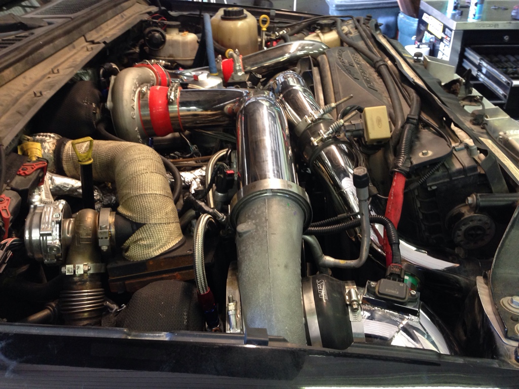

Kinda like this,
But I must say, one of the most rewarding things of my job would be getting to see, drive, tune and enjoy the look on a customers face when they come to pick something like this up....
