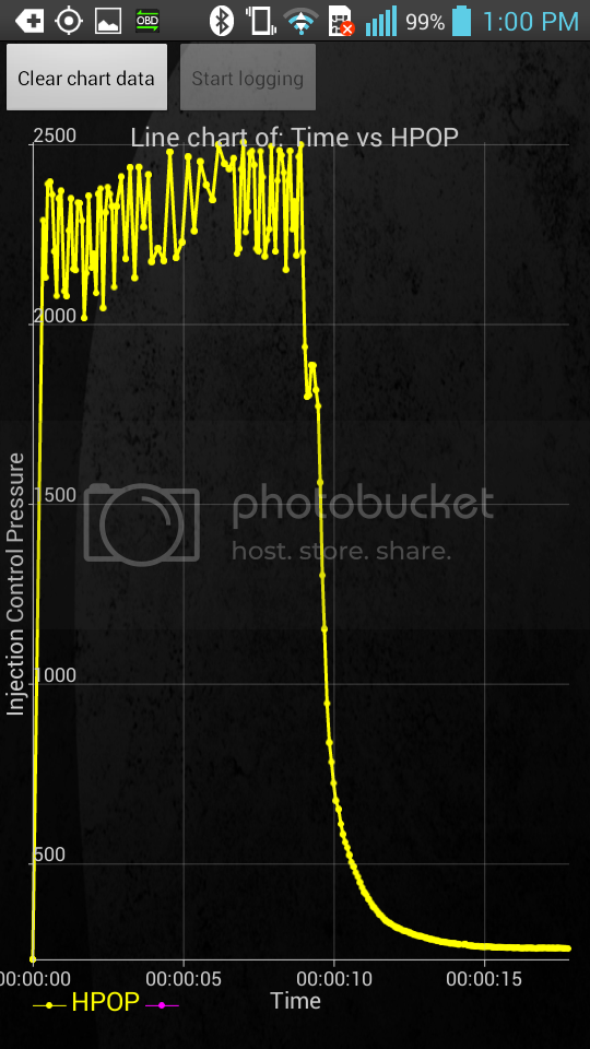

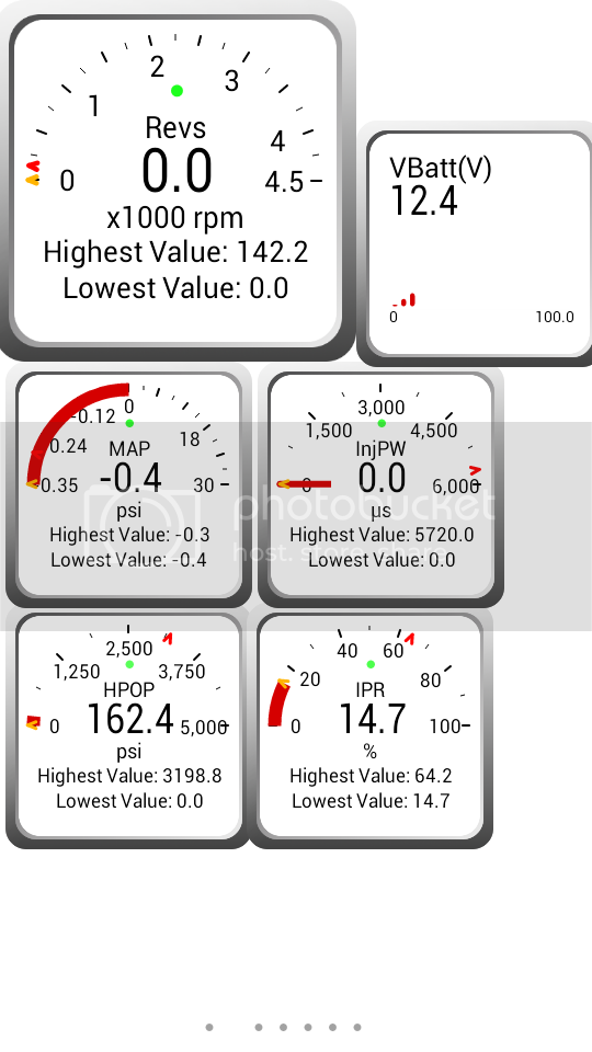

Graph of ICP
RPM,V,ICP,MAP,HPOP,PW,Duty cycle

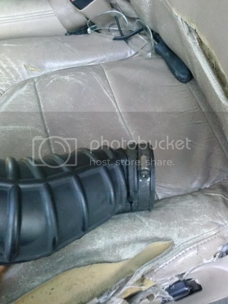

Ripped boot

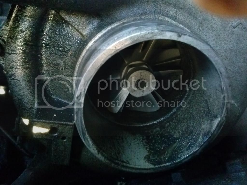

Turbo

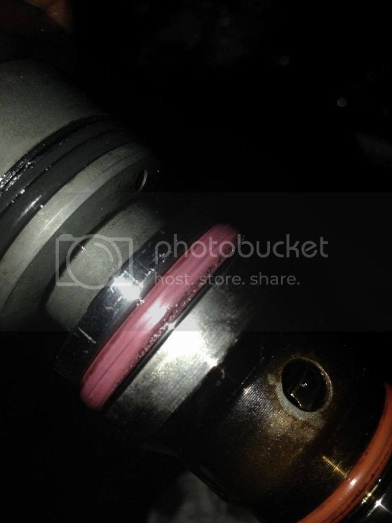

O-Ring

You might pull all the injectors, reoring and/or flowtest. While the injectors are out, bar the engine over, and make sure the cylinders are not flooded.
Take the starter off, have it checked.
Sudden stop cranking is not good. If all that checks out, you should be able to put it back together and run a compression check.
