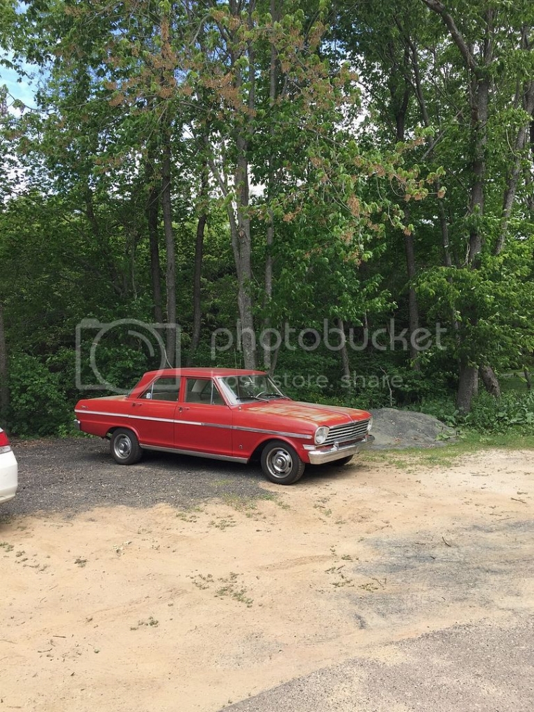

Also picked up a little toy about 3 weeks ago. 63 chevy II nova, has disk brakes already, subframe connectors posi unit in the rear, gm zz4 crate motor with a lunati cam and edelbrock 750cfm intake, electric fuel pump, roller rockers, full msd ignition, dougs headers, lake wood drag shocks front and rear, th350 trans with a b&m converter, and transpak, and a b&m slap shifter. Plans for it are to make the car the toy and the truck to be a 700hp tow pig on fuel and spray it to whatever i can. The car should go 9's by the fall, most likely going to turbo the car, but for now just spray it with nitrous and add some better heads.
I wanted a 2dr but couldn't find anything near me so i ended up with a 4dr. It will be daily driver. Right now its turn key and go except i can't go far because it the v6 radiator in it from 1963 the car only has 60,000 miles.
