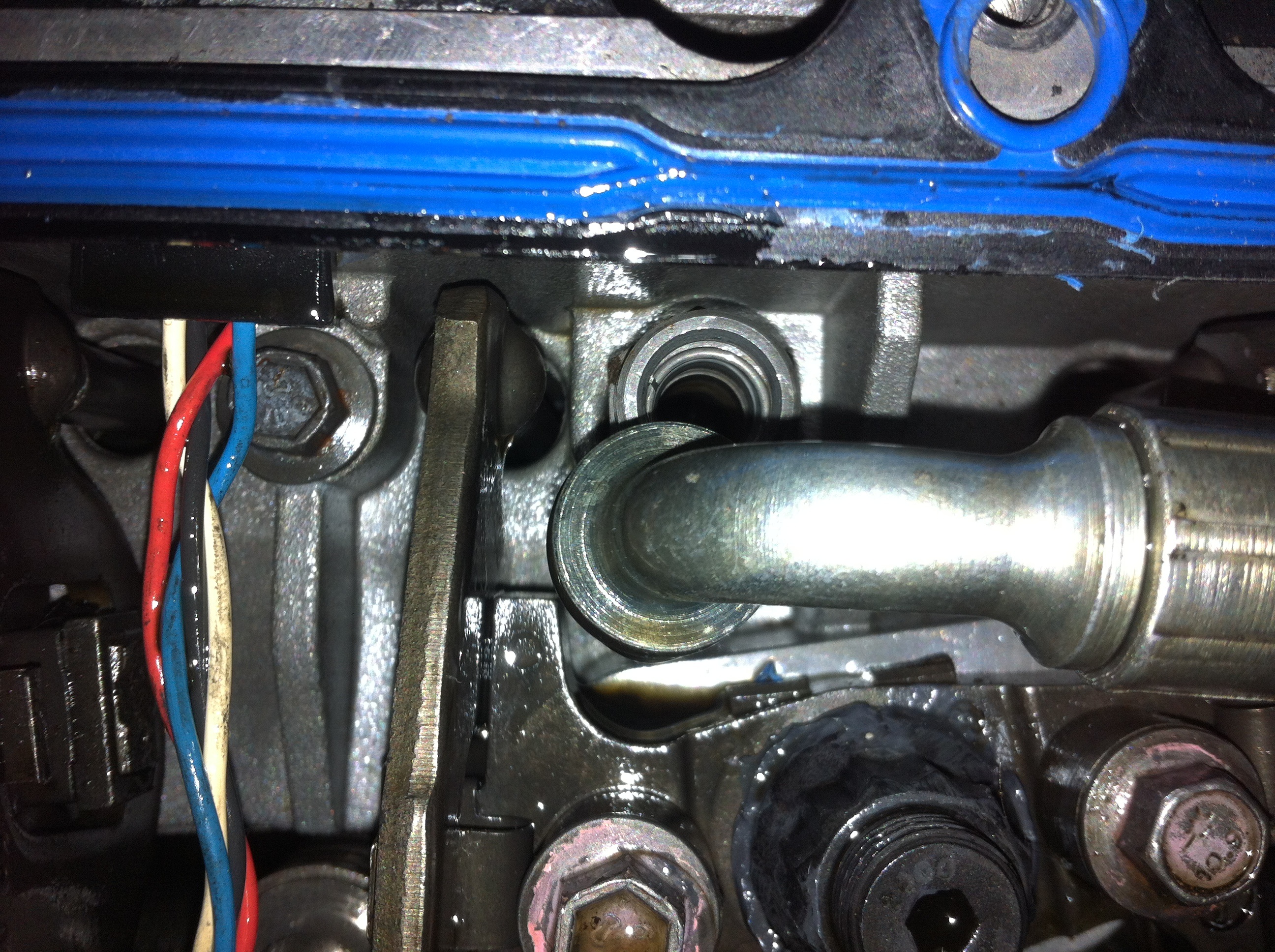

New injector no start
Well this is what it was. I did have a little bit of a tough time when I was putting it on. I'm actually glad that is all it was.
It happens man.. Lol. I think that falls well within the realm of a leak!!!
