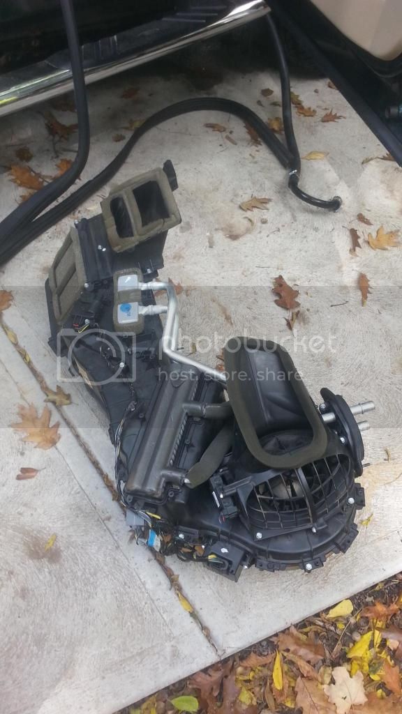

there are no actuators/valves between the firewall and the heater core. The actual heater core tubes are like 18" long and run all the way through the firewall. I traced the lines and they run back to the engine
