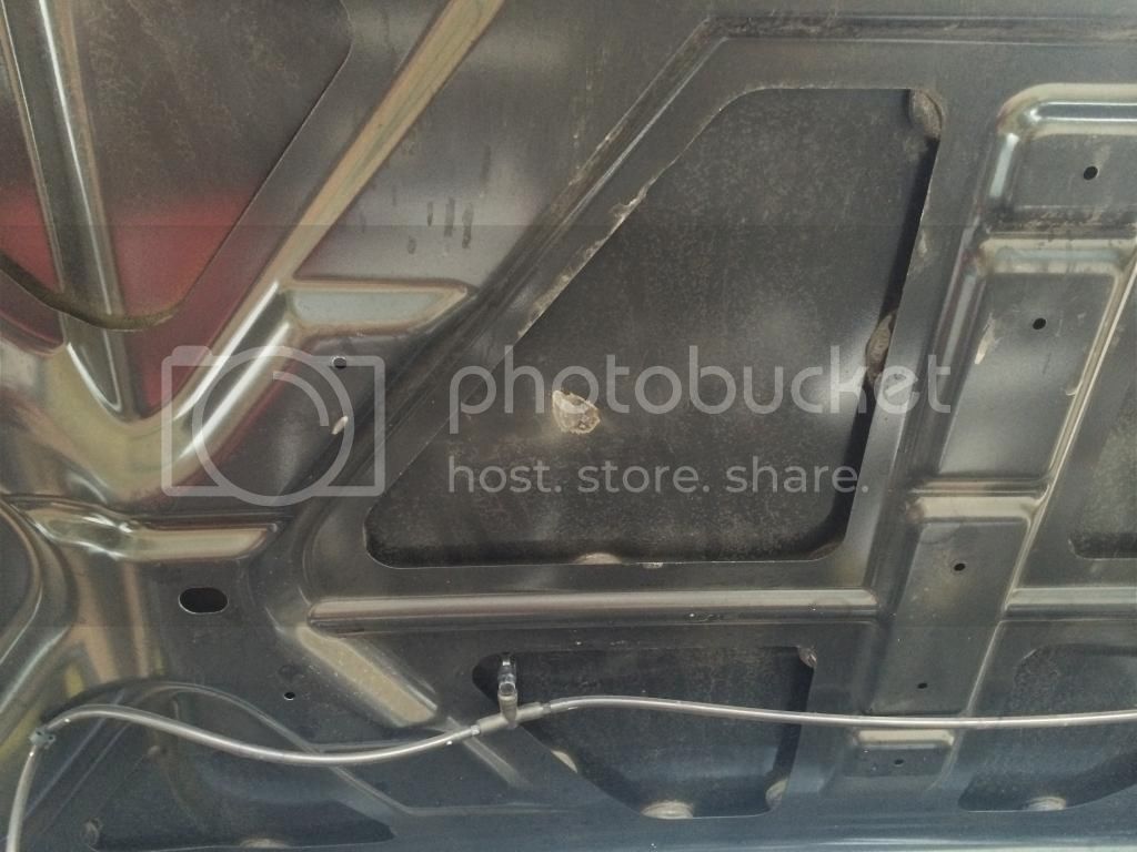

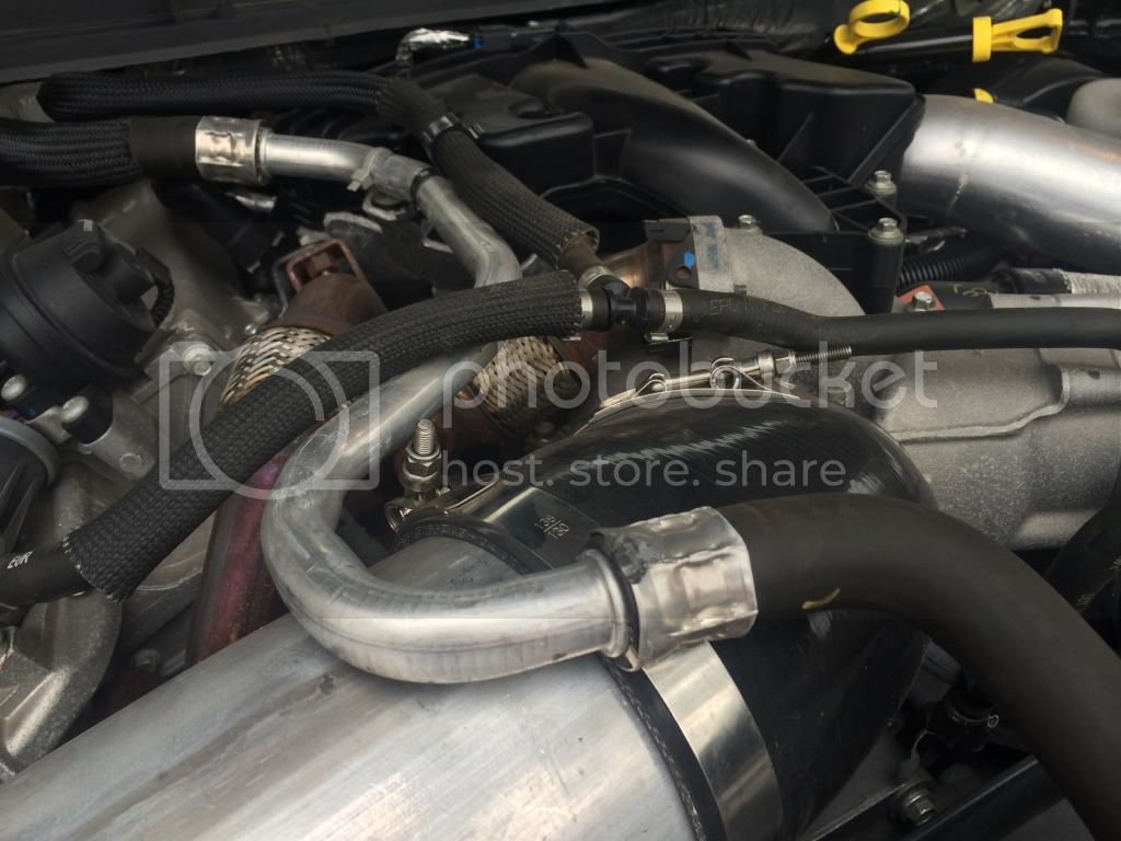

If you have stock egr and use a no limit intake, be sure to double check your clearance. I saw where it was rubbing the pipe early on, just been too busy and lazy to take it off with the egr plates. About to do the job this weekend, and noticed now it's been sandwiched in between the hood, rubbing on both sides. Also before the nut swingers come out, this is just an FYI to double and triple check because it's tight in there.
