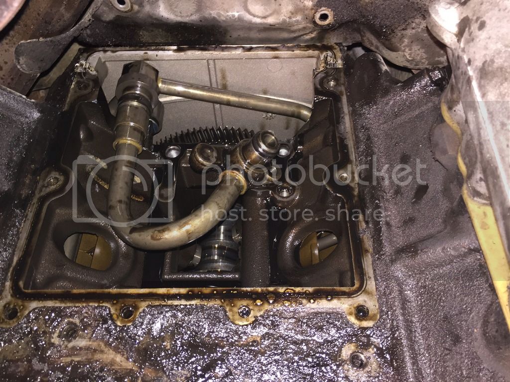

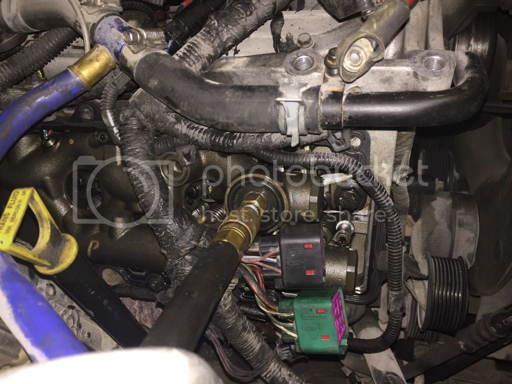

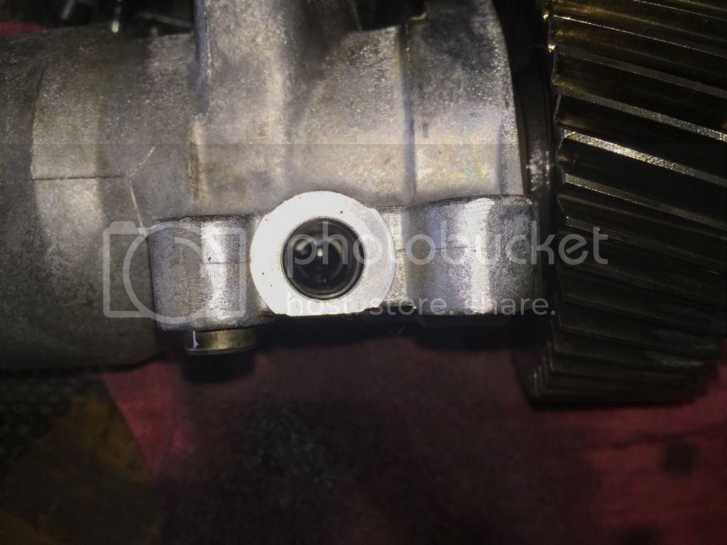

Ok went this morning and pulled the hpop. I found the leak after I pulled the hpop cover. It's a hole in the side of the hpop where the oil supply for the pump is located. I toke some pics. It also appears it has a snap connect fitting. It is the old style aluminum pump.

That's the ball bearing someone mentioned a few posts up.
