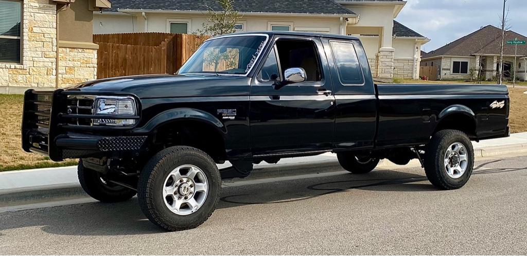

Is there a lift on the 05 swap, or is that the 05 factory height?
2” level.
Still slightly higher in the rear, even though it doesn’t look it.
Checked with a long level haha.
The springs are unknown as far as weight rating.
They came with the entire chassis I got to grab the suspension off of.
Im sure the bumper comes into play as well
