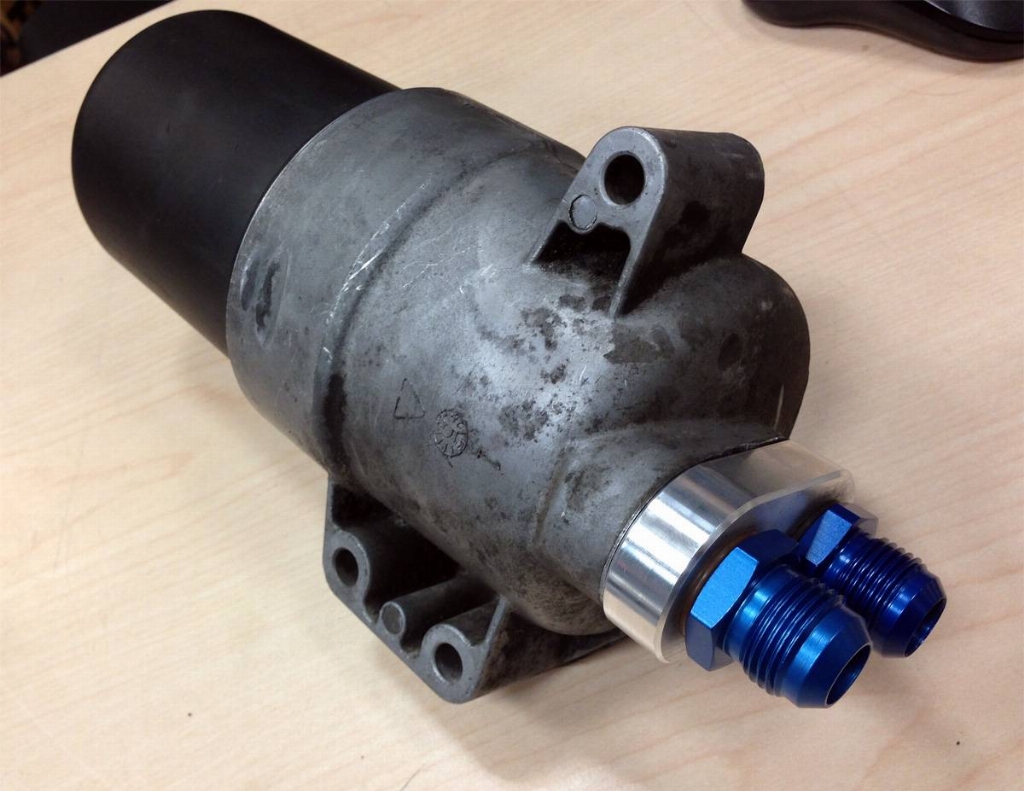

Using a 6.0L van housing and a custom machined adapter to convert to AN lines

I am assuming this is to keep the pressure differential low or as close to factory as possible.

It just takes the guess work out of it. Ford already did it with this setup, and the truck still uses the same ole' filter as it used to. Utilizing the same size line as the factory van hard lines (-10) and you don't have to worry or wonder if the filter is flowing enough, filtering well enough, or worry about drain back, its already built in just like the factory filter.
