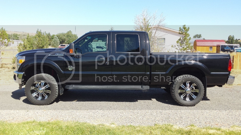

So,dude at the dealership assumed "lift/big tires".I am running 35's,but I don't think it's lifted,just a leveling kit up front.

Not too lifted at all. I think 262 is a bit too hot. For what you were towing.
