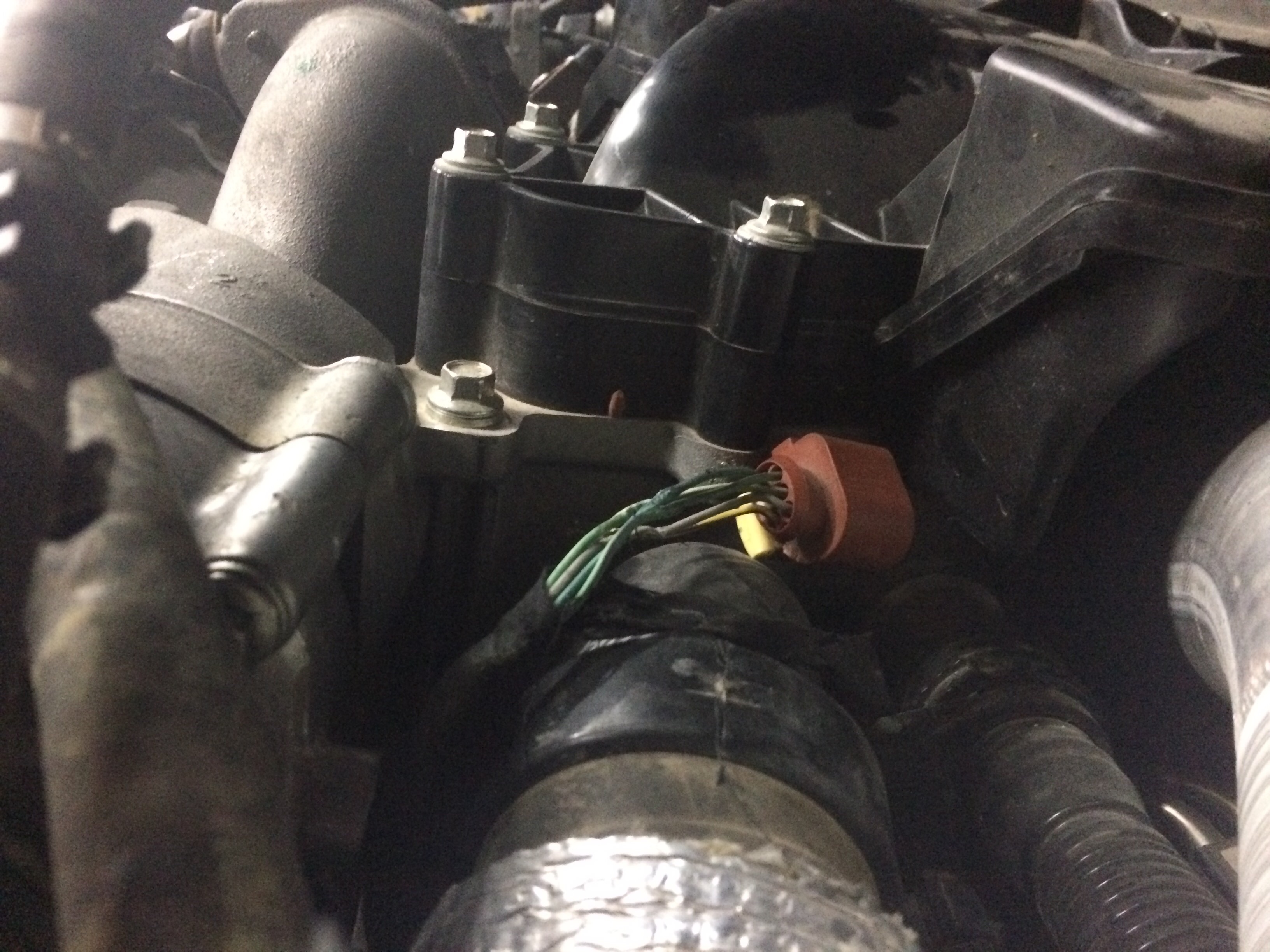

2013 6.7 with these codes randomly popping up, truck runs great but on decel the turbo will sputter with white smoke out the exhaust and occasionally die. Will restart and run great as long as you are accelerating. Freeze frame data showed -40 on fuel temp sensor. Truck runs fine when cold but acts up once it is up to operating temp. When it acts up I can watch boost gauge jump back and forth with IDS showing vacuum on map sensor at times, I can disconnect map sensor and it will run fine just lazy.
I have tried known good Mass air meter, back pressure sensor, rail temp sensor, Map sensor. Thought I would ask before I pull more hair out.
