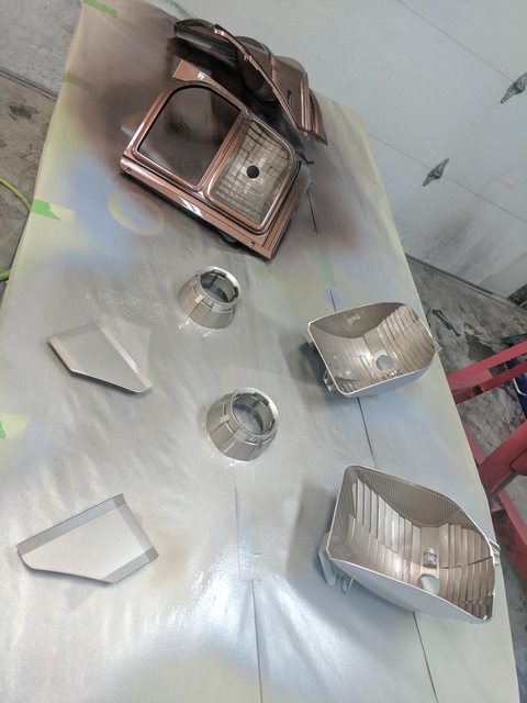

I then scuffed the plastic with red Scotch-Brite pads. Setup a nice table to spread out all the headlight parts for paint. Warmed up the garage to 75-78 degrees and sprayed some SEM plastic adhesion promoter. After spraying the adhesion promoter I was ready to spray my 2k epoxy primer. I just mixed up some OMNI brand primer I had laying around and shot it. You can also find paint cans with activator in the bottom at most auto paint supply stores if you don't have a gun to spray paint with. Although the final product always turns out better if you do spray with a gun!
Next came base coat. I used Deltron DC2000 basecoat. This basecoat sprays like glass and only needs 2 coats. I did the two colors in two stages and masked things off with some 3/8" medium hold masking tape and some plastic. I forgot to take pictures of the masking step. I was going for the iron man look here.
Finally came clear coat. I went with DCU-3000 clearcoat, a production clear, which cures even quicker than the 2021 clear coat I mentioned in a previous post. I sprayed the first coat, wet, waited about 4 minutes and then immediately sprayed a second coat, also wet. No runs or orange peel. I love this stuff. After 10 minutes @ 75 degrees the clear coat was dust free, after 25 minutes @ 75 degrees the clear was tack free. I then set my oven for 125 degrees and baked the parts for about 8 minutes. This fully cured the clear coat. The headlights were ready to assemble.

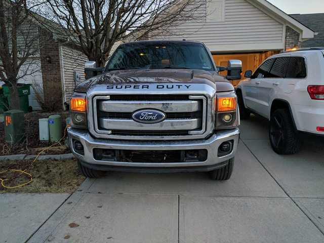

Next came reassembly. Please excuse the dirty truck. It is winter after all.
