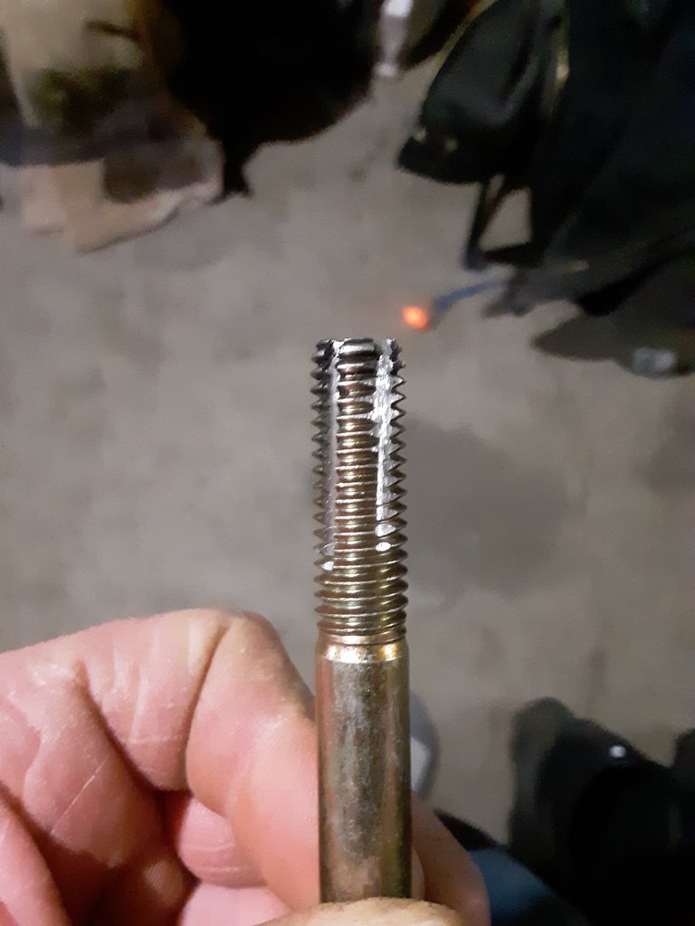

This is what I am talking about. For the head bolt I would do six of those notches.

Thats precisely what i was thinking. i like the angle of the cut.
It works for me. You play around with the notches nd angle of then cut. But I figured as long as its able to clean out and collect the junk on the threads, it's good enough.
It's also cheaper than buying a tap.
