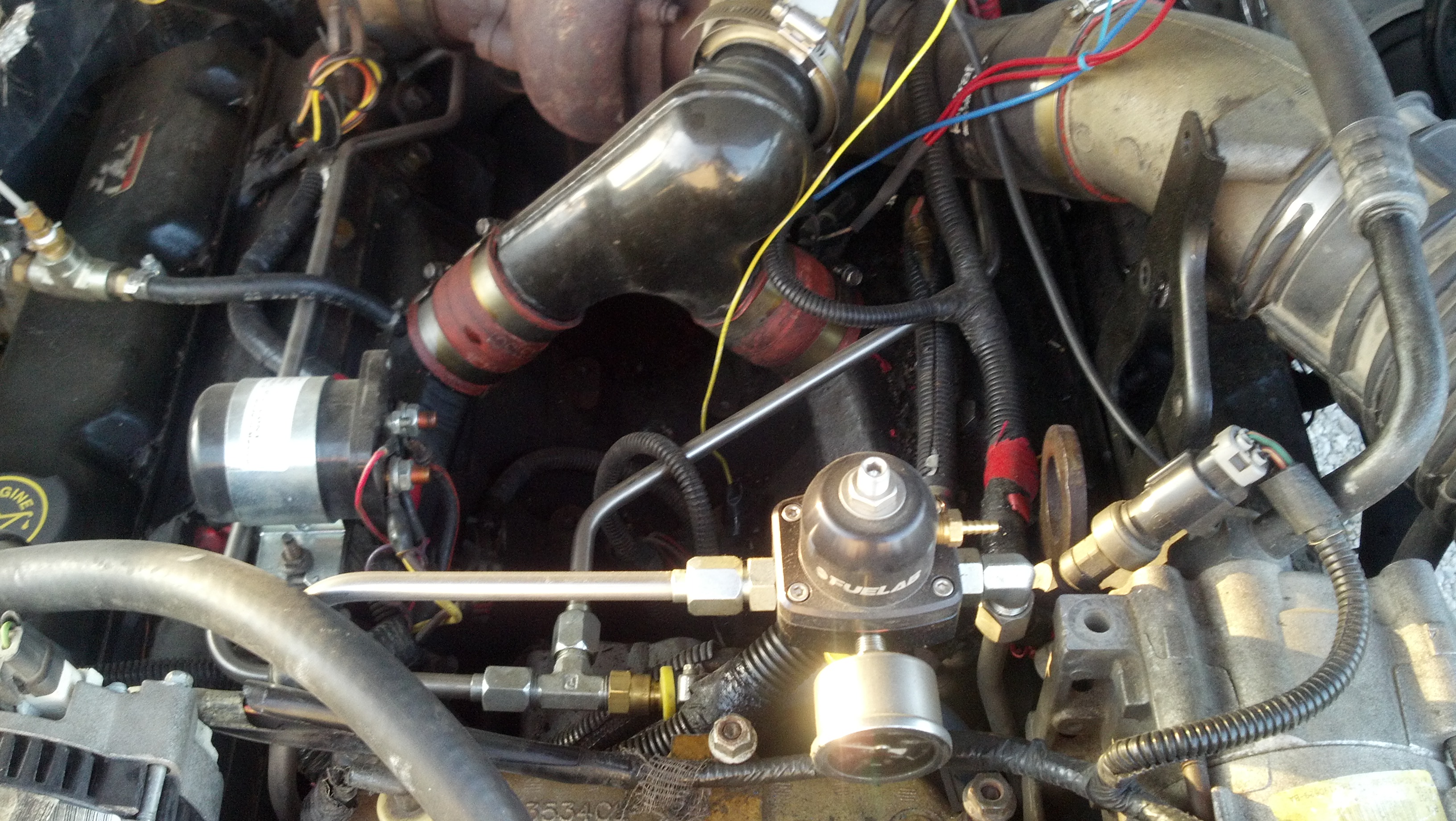

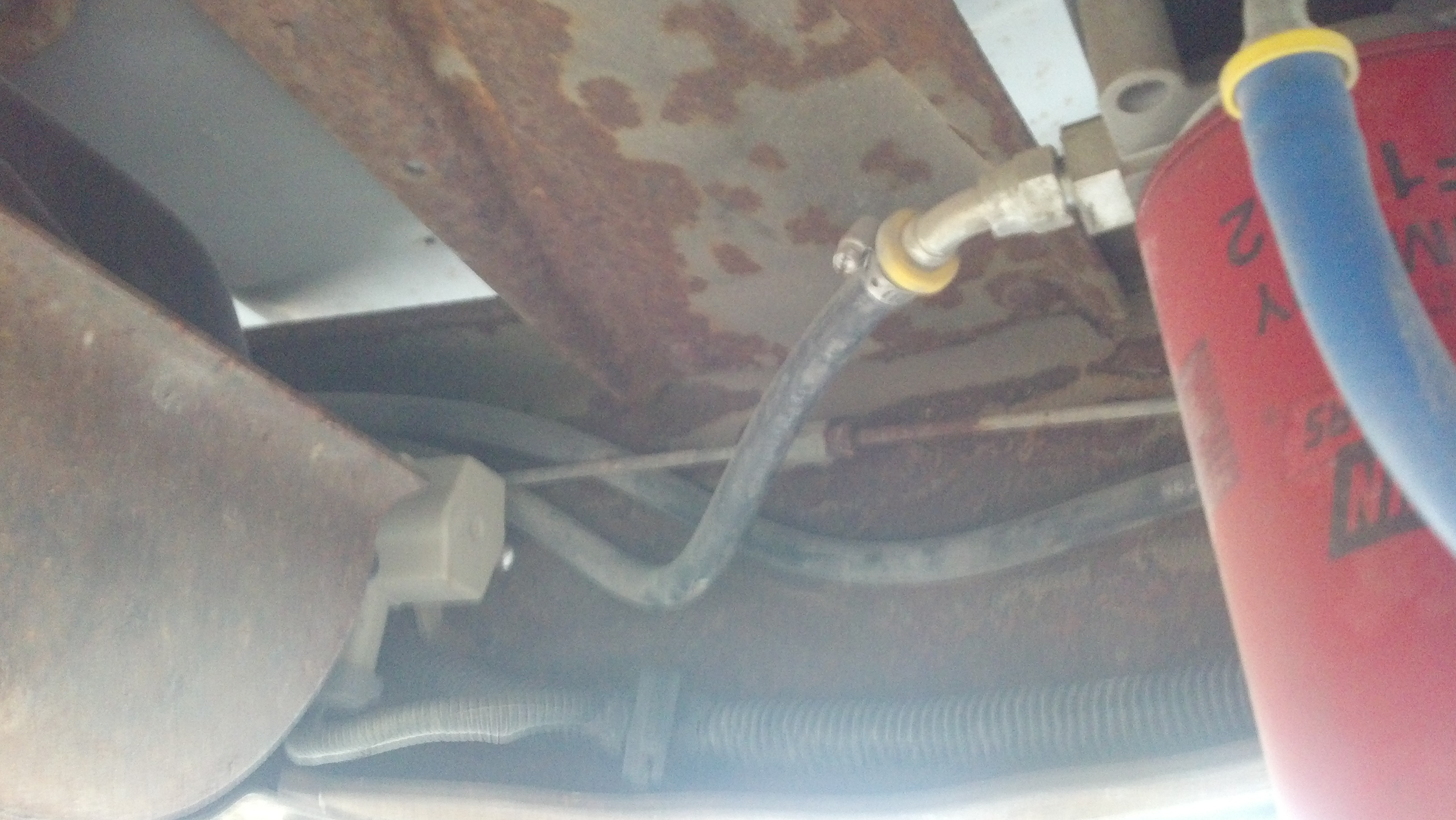

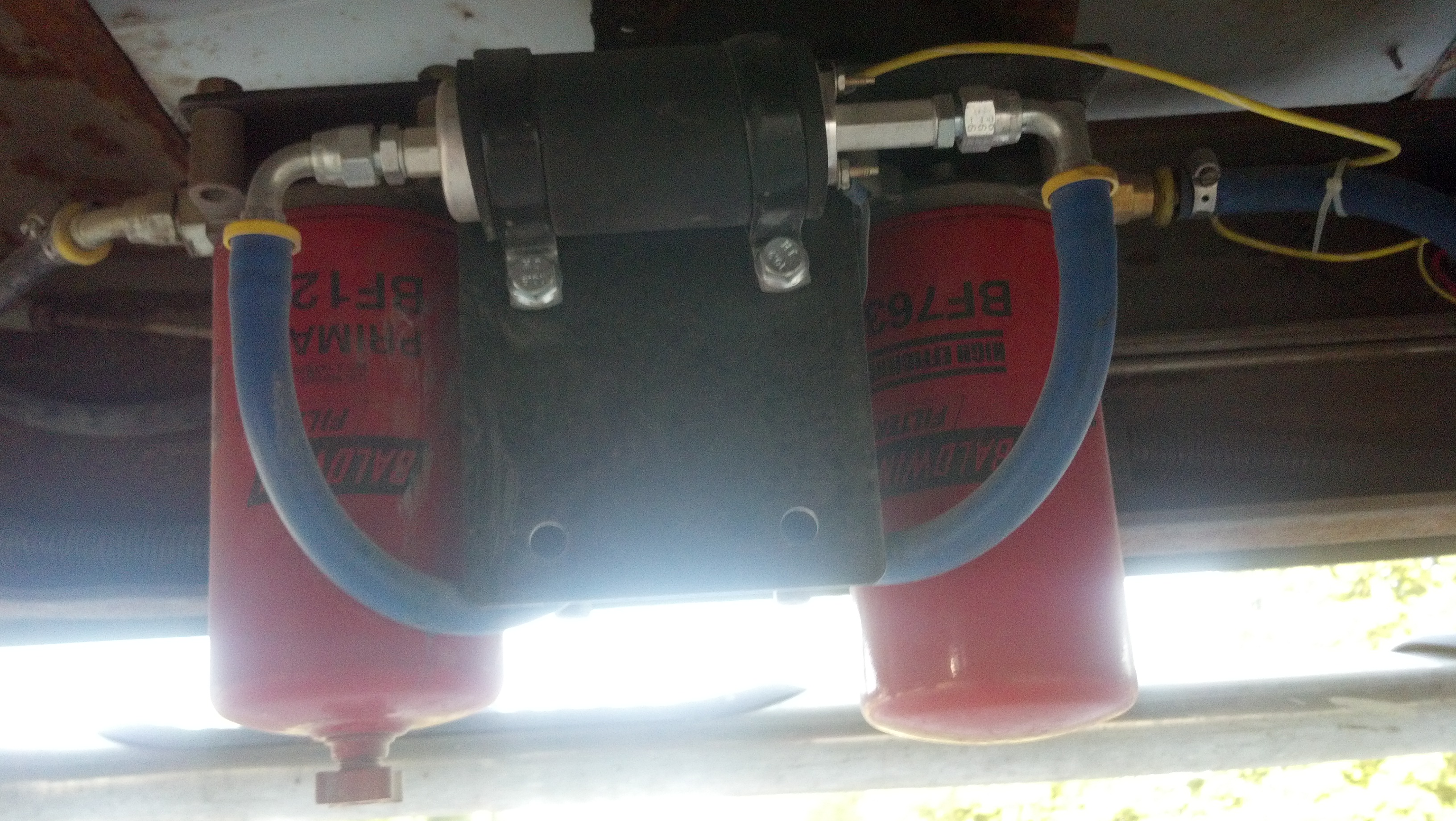

The top and bottom side, just general pics. I have his pump/filter mount and want to see if I need to do anything specific for my final install, hopefully this week. My mechanical pump is only making 20-25 psi at idle.

And that psi is with a BB in there.

Here are some photo's. Disregard the poor cell phone pictures, and my less the professional wiring job, haha.
