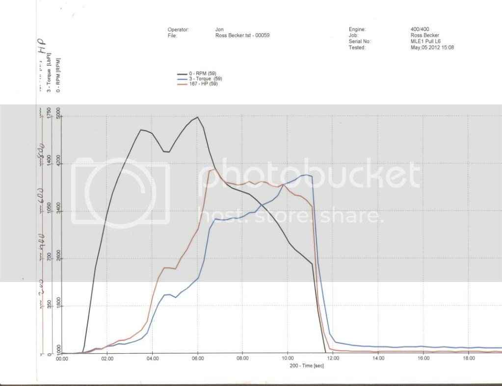

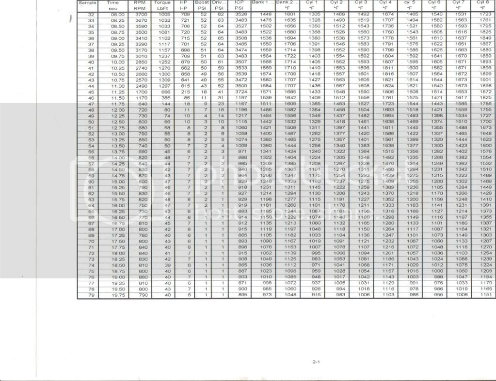

so I went to swamps last week with my engine with hopes of makeing more power at higher RPM's It took three long days but I think we were pretty successfull:ford:
that was not the highest hp pull we made but definatly my favorite one. 700+hp from 3000 rpm to 4400 rpm with peak hp at 4100 that was about the 20th run we made that day and we think total power was down some due to heat.
this is with swamps 400/400's and an 80/88 bfh turbo and a stock bottom end
we have a lot of fuel left but ran out of time and I decide over 60 dyno runs was enough for one week LOL
these things sound awesome at 4500+ rpm by the way
