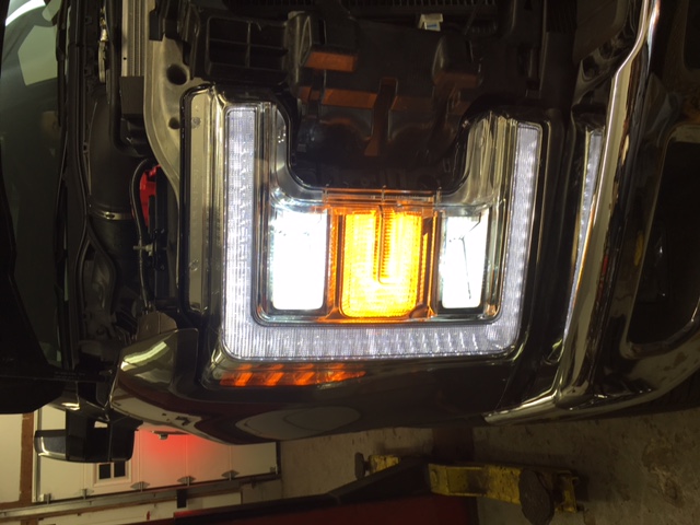

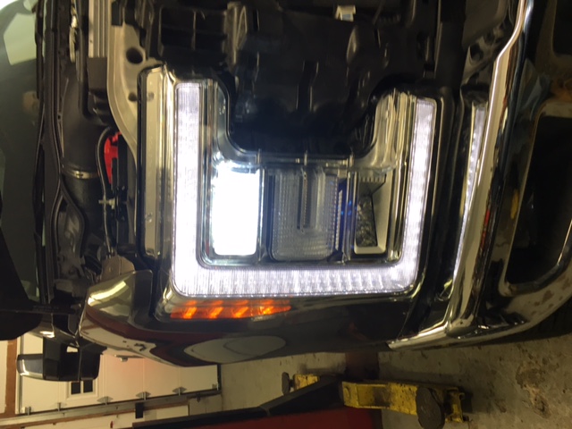

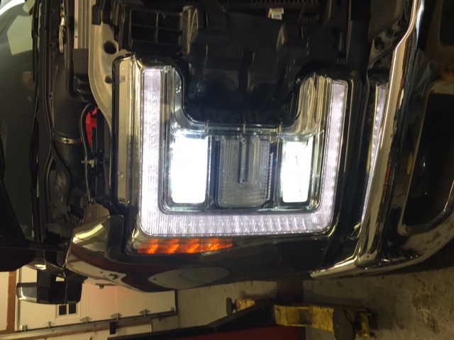

I just went from halogen tail lights with bliss to led tail lights with bliss.factory led headlamps on order now.
fdny136
Dec 4, 2016
22
halogen to led
