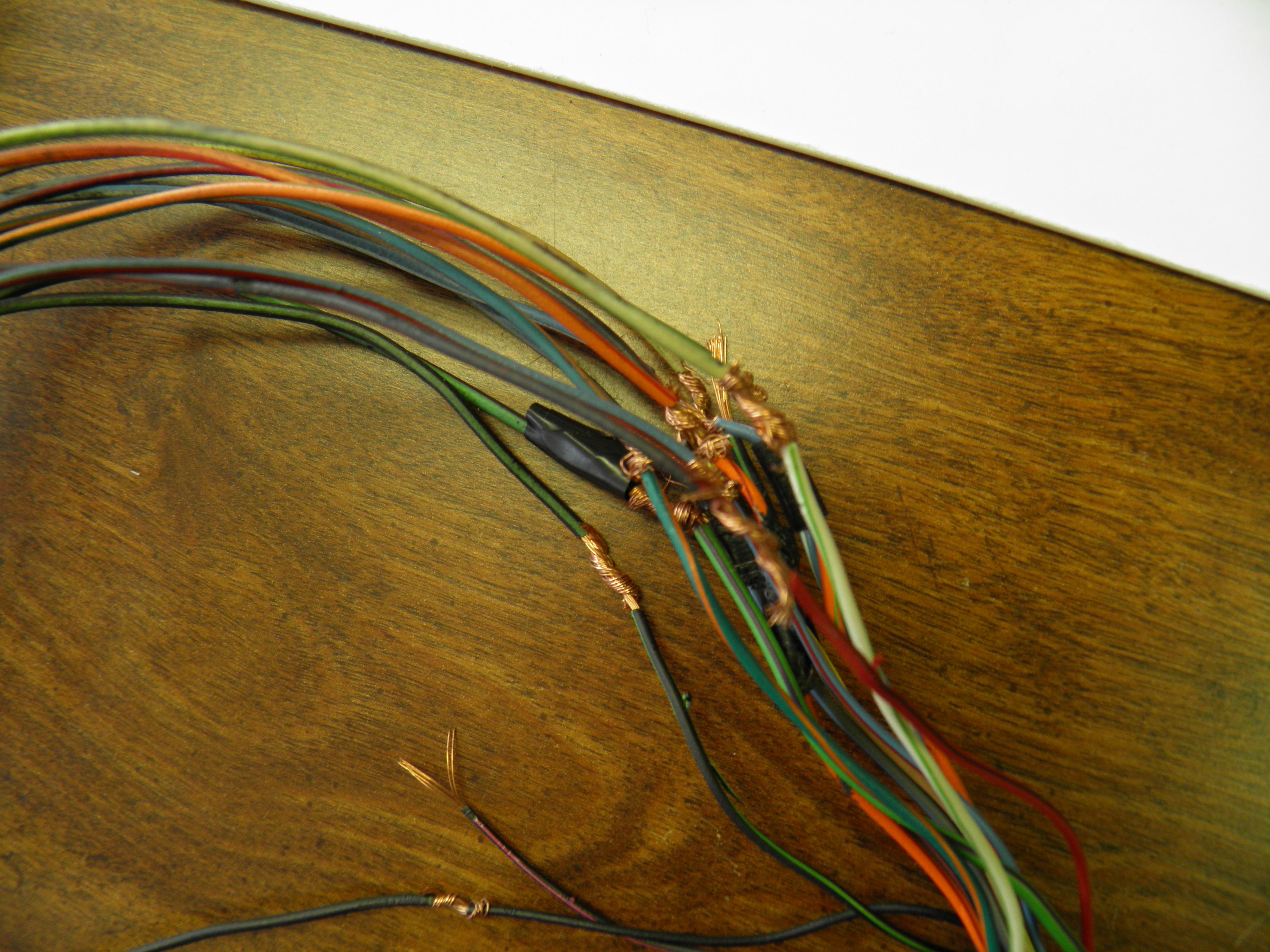

Seems like alot of work for a stock radio.
There isnt an extra 12v positive or ground with the 05 up. Also theres no curve in the radio. And the colors are different
Sent from my SCH-I925 using Tapatalk
There is a signal wire in the loom for steering wheel controls. There is also a wire in the loom for speed that controls the adjustable volume bbased on vehicle speed. Past that you should have speaker wires 4?. 12v memory. 12v switchable for power on. A wire for illumination and a ground.
And you know for sure the radio worked previously right
