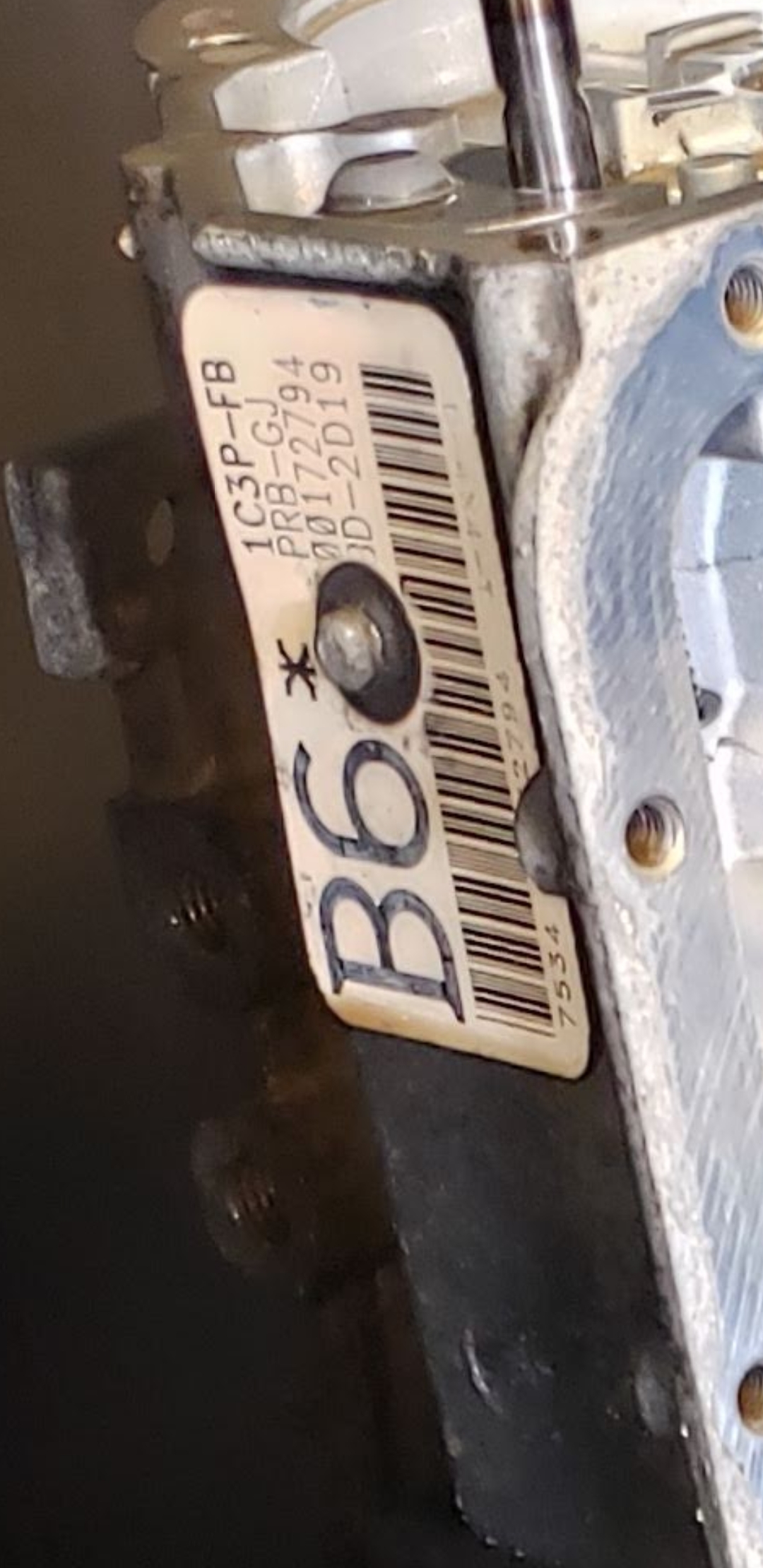

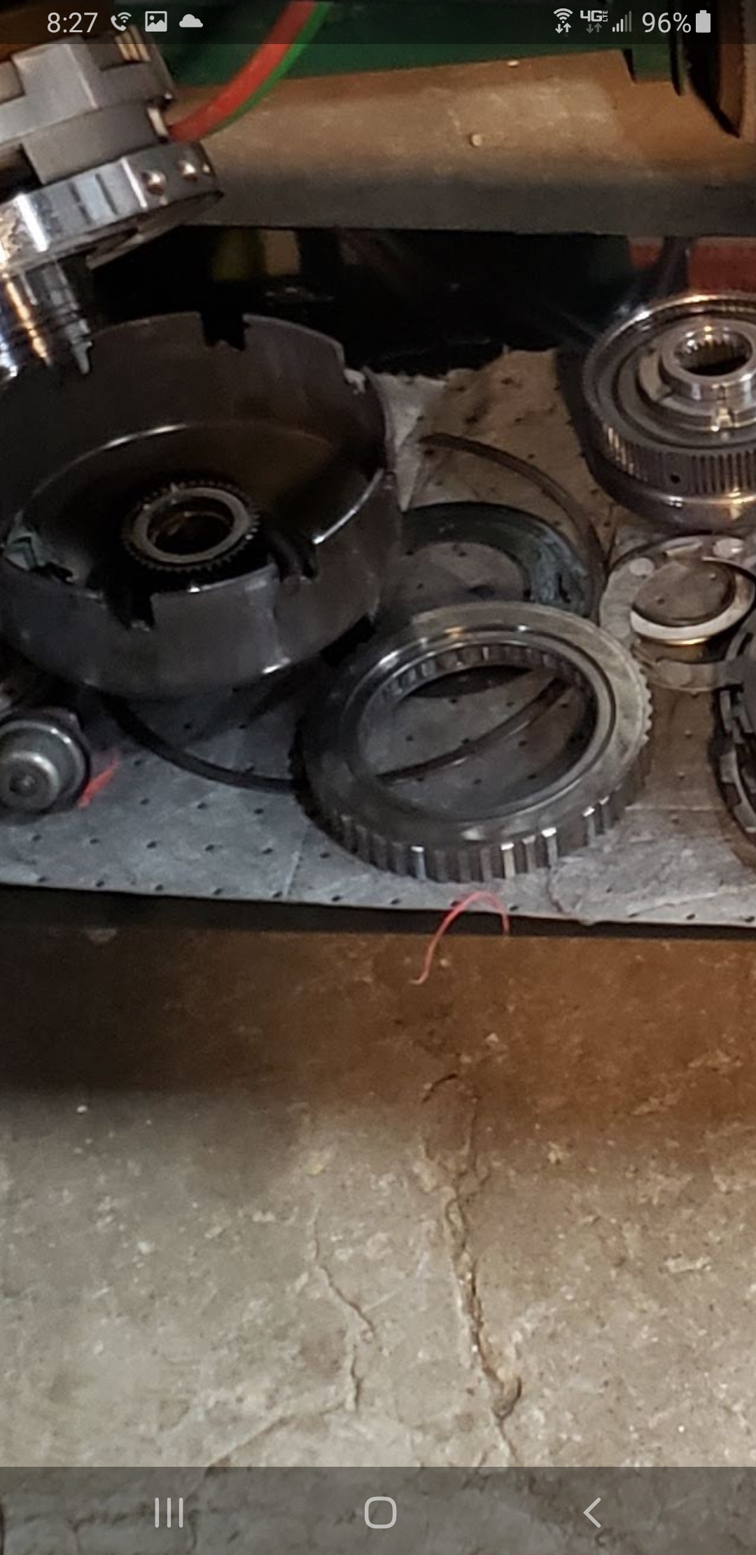

Does his tag tell you anything?
And this is the diode right?

That tag does have the trans build date. But I don't know how to read it.
And that one way clutch looks like a sprag to me, not the mechanical diode.
EPA
Feb 2, 2019
232
Tag read BD-2D19
Buid date- year, month, day. 2002, may 19th
This is how i have known the tags to work, I could be wrong but so far it's been accurate.
The month is a,b,c,d ect... A being January.
Ok I'm just a little confused. That gear wih the diodes inside of it, I thought that's the dreaded mechanical diode?
Once it was installed it only turned one way.
