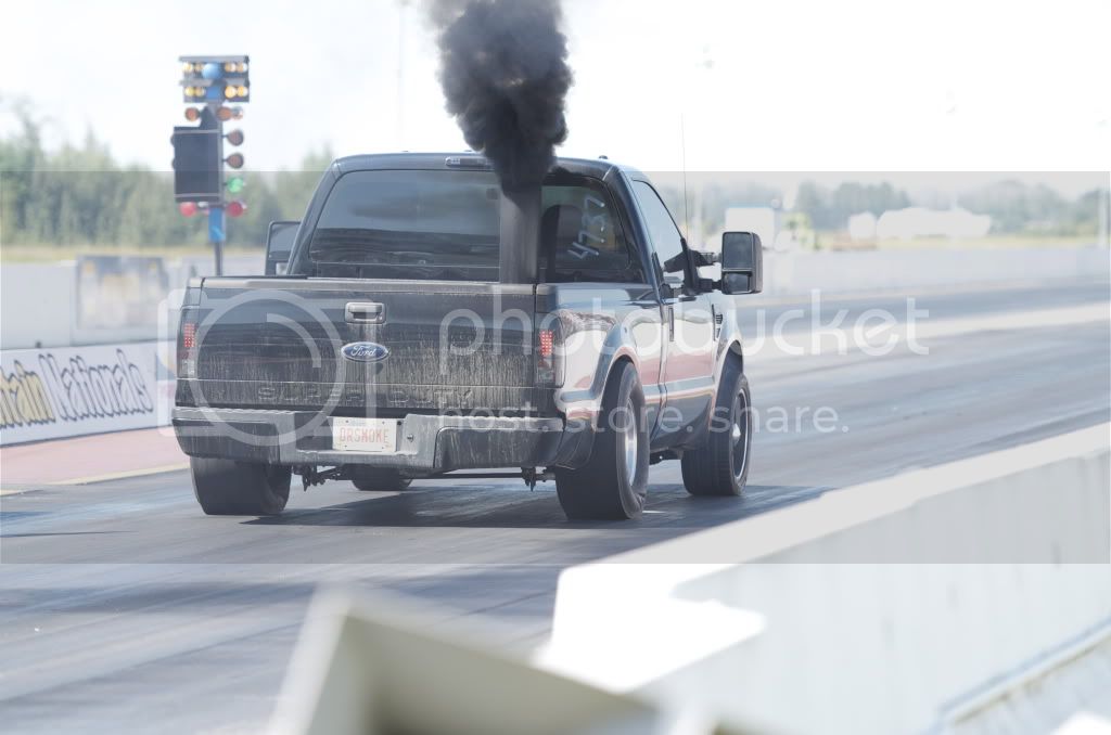

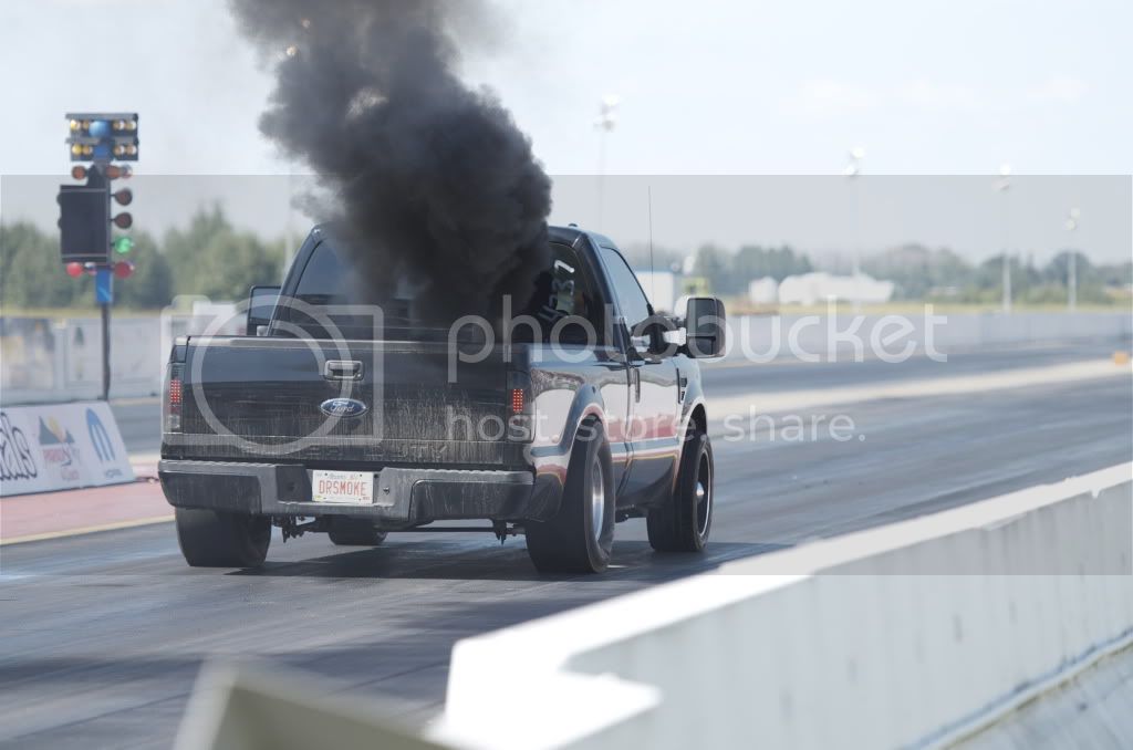

Although his 60ft's were only 1.8 and one 1.7 he was getting it to launch relatively good. The 4 link wasn't set up at all but he still managed to come outta the whole fairly good.
Malcom Cross was very very kind and he gave Rob a few very good pointers for him to implement and promised his 60ft's would drastically improve. Thanks again Malcom for being such a great sportsman and I'm sure Rob is looking forward to using your input.

What are those three pics showing us?

It shows the truck squatting and some wrinkle in the rear tire. Just means the truck is hookng up and getting out of the hole harder vs. Just spinning. Big deal for a 2wd truck.

Almost looks like it needs an anti-roll bar incorporated in that rear suspension. What is done as far as the front suspension goes? Glad to see it coming along.

I want to thank Ryan a lot for them photos they show me so much about how the truck is squating and that the tires are working. The truck has a lot of rake usually and it is squated so the 4 link and the slicks are doing there jobs.
