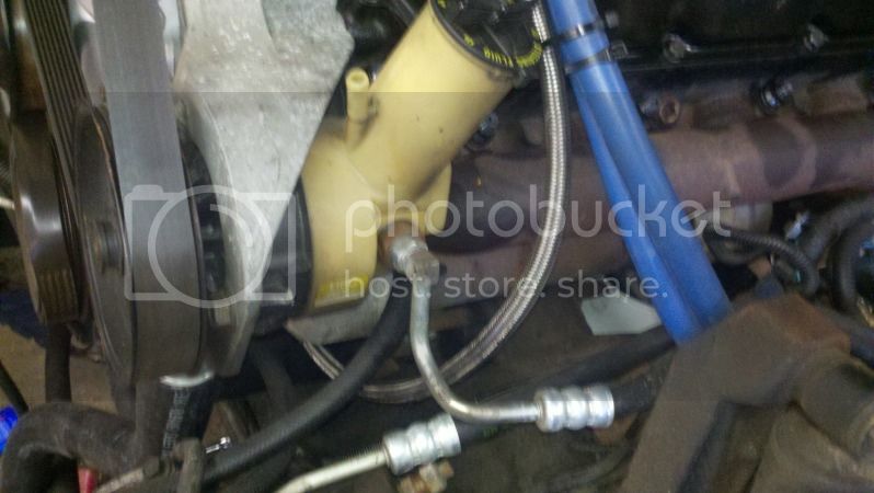

Looking for recommendations on where to get the best secondary feed
to the HPOP resivor and what fittings would be needed.
Would be routing to the HPOP fill plug.
Thanks!
What would be a reference of where location of this plug is to the oil cooler?
Just an FYI. Pulling oil from the main galley is taking it from the area it was designed for. If you need to have additional volume in the HPOP res. make a restrictor pill and start with a small hole. This will allow you to maintain volume to the main and cam bearings with just enough to keep the high oil consumption injectors from depleting the res. Open the hole in the pill to find the safe balancing point.
