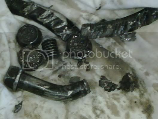

caladash
792
In A House
This was all I found besides a bad u-joint. I'm not a pro but there is a bit of slop in the gears when I move the tires. Clutches all looked good from what I can tell. Maybe I just suck.
