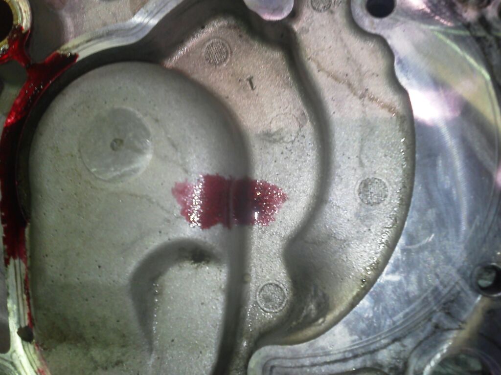

Heavyhaul
1,063
Wyoming
uploadfromtaptalk1342358880591.jpg. I used a die penetrant to test my front cover. Makes it easy to see.
devdiesel
Apr 2, 2012
376
Barrie, Ontario
it was covered pretty well earlier in the thread but the just of it is that it happens mostly when a truck is run really low on coolant, air is introduced and the coolant boils eating away at the front cover behind the water pump. I can also happen when low quality coolant is used ... preventative measures would be just keep an eye on your coolant level and flush it once in a while.... well I've been driving my truck all week and no coolant loss or sludge present on the valve cover.. looks like the front cover was the culprit!!!
