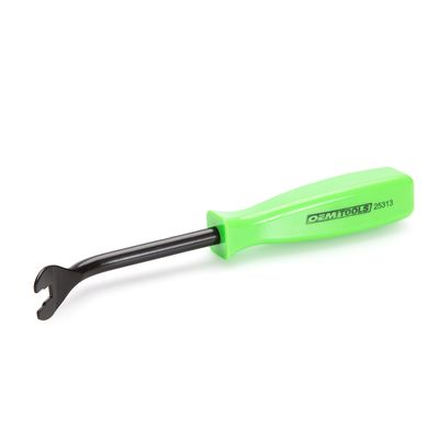

Pick up "Upholstery clip tool" from any of the auto stores. Take a dremel or round file and start to round the opening to fit the STC fitting. You will get the idea when you see it. Will take about 5-10 mins. The tool is $5-$15. It will work exactly as the "proper" tool works. Putting a little bevel grind on the inside edge so it ramps up in thickness from the edge will make it basically exactly like the STC tool. But it will work fine either way. I have made a few of these and keep them in my vehicle, along with a set of the hpop hoses and 2 gal of oil, as well as one in my various tool chests so I always have one. Nothing worse then being on the side of the road at night in the dark with a blown hose and no way to change it out. The two screw driver thing only works easily when its convenient. Trust me on the side of the road it will for whatever reason be a royal PITA.
http://www.autozone.com/autozone/accessories/OEM-Upholstery-clip-tool/_/N-25qz?itemIdentifier=48579_0_0_
This one is $9.99
You can also do it with a door trim tool as well. Anything that gives you that basic flat metal paddle end with a cut out thats not too large to begin with. I like the above as its solid and the right thickness.

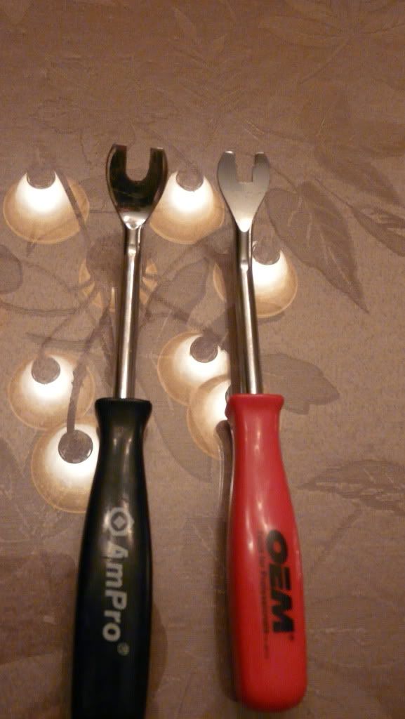

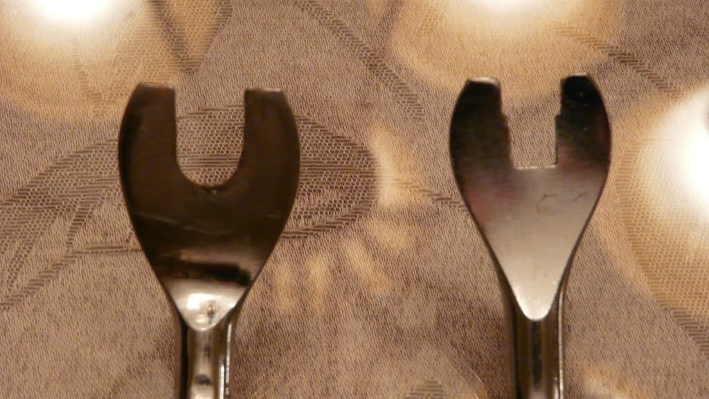

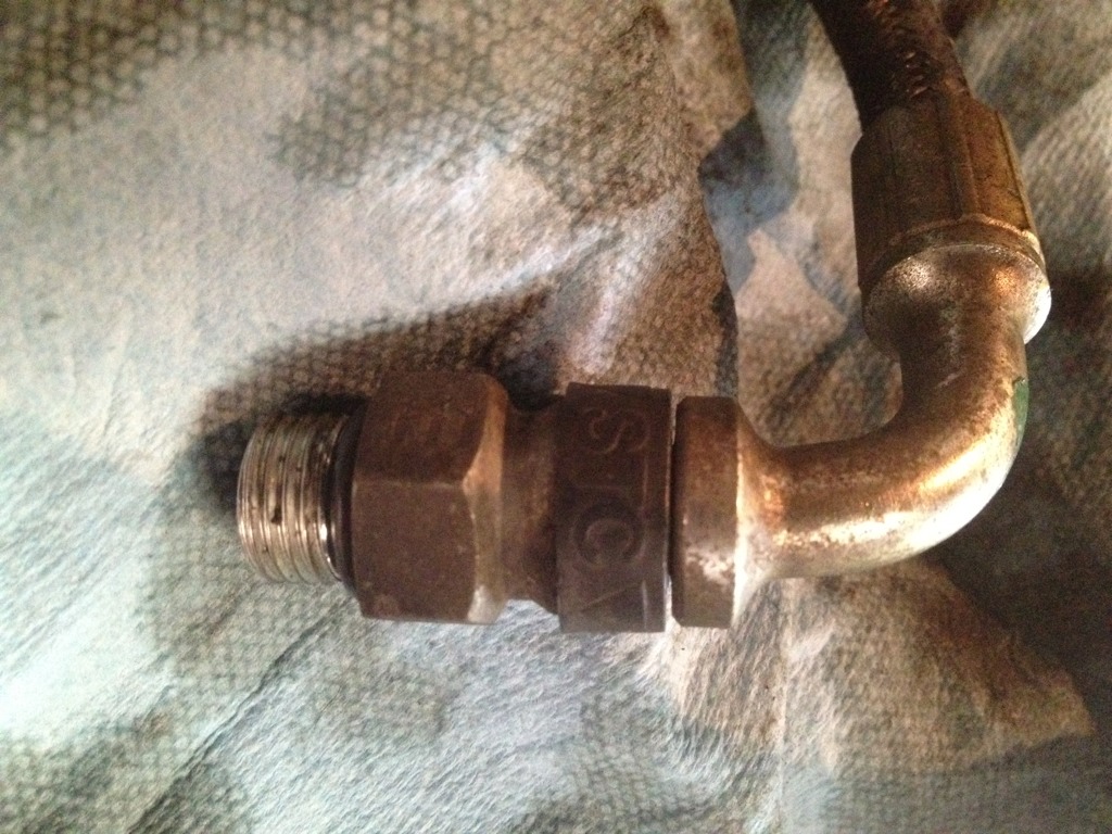

Here is a before and after photo of what it looks like. These are two tools as you can see they have dif color handles but they were both the same org design. The red is still org and the black is modded for the STC fittings. That is all there is too it.
