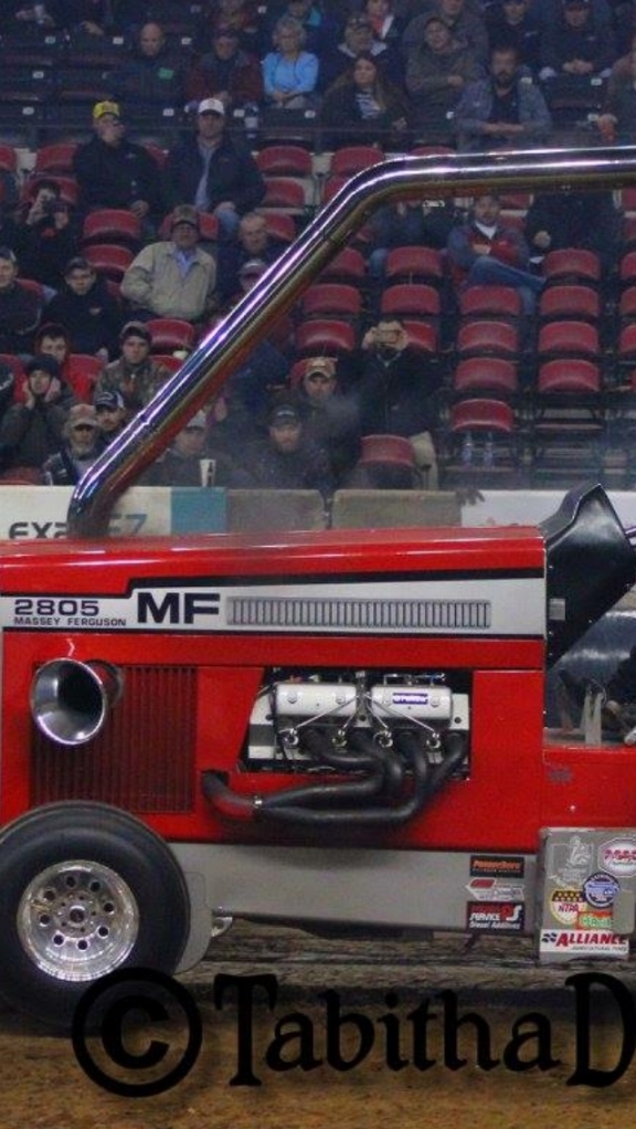

I'm actually thinking of making a set that resemble these.
Magnum PD
9,566
8
VA
Wonder why the first header has to go back to the center in that pic?

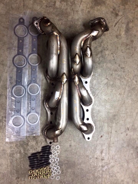

So far these have been working great, 1/8" wall stainless argon purge welded and for best results get them coated. They are heavy!
