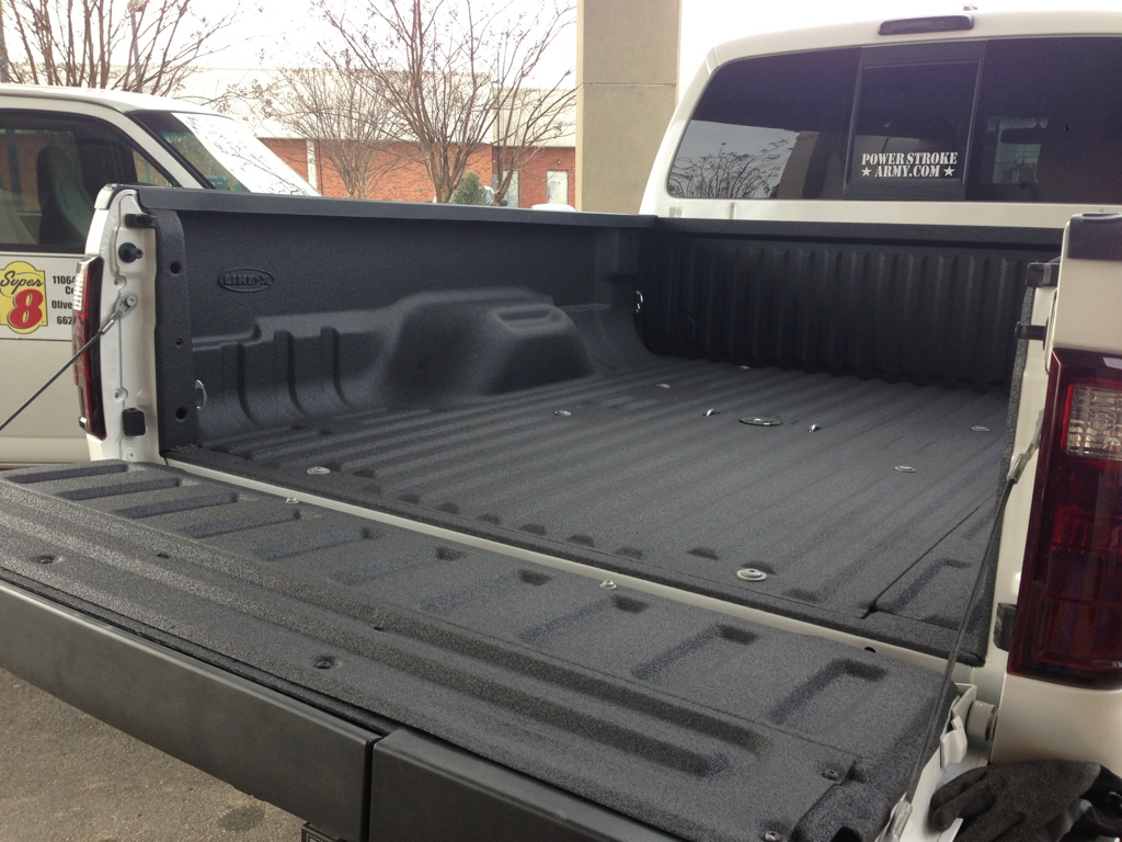

Well.....it took me forever to find time and shop space to get everything put together but the wait was well worth it.
Here is the finished exterior.
This thing rides and handles like a dream.
Need to get it cleaned up for some better pics.

B&W. This one won't be a "one trick" pony. Thing is ready to do work now. Looks great Shone.

Thanks bud.
Still need to install the 7 way plug in the bed.
I like the tailgate setup. Where did you get it from?
Where do u get the plate to remove the man pole?
Ford off a tailgate with the "non pole/step" option.
Bolts right in
Yup.
Its a ford access panel off a tailgate I had laying around. Just undo the torx bits on the plastic liner, torx bits on the actual pole, and bolt this plate right in its place.
The part # for the plate is 8C3Z-9943121-A
Youll also need to ask for the torx bits to screw it in, I don't have that off hand.
