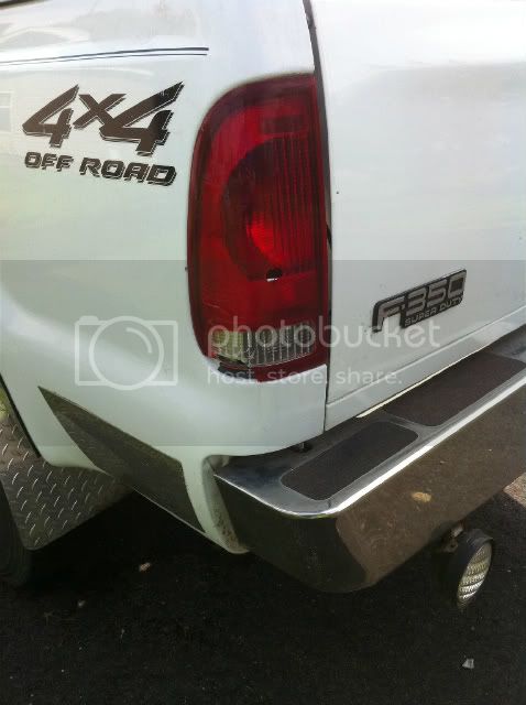

One of my taillights was shot out before I picked the truck up:

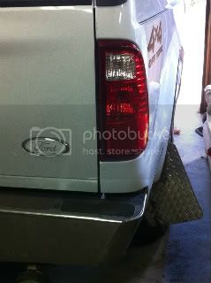

I had been debating on what to replace them with when I came across a good deal on a couple pairs of 2011 taillights.
The conversion is very straight forward:

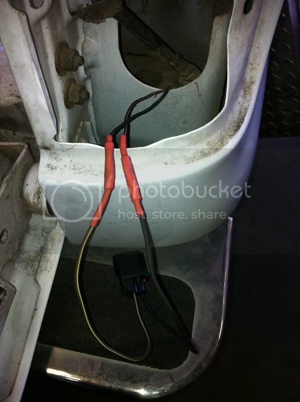

Cut wires for reverse lights and splice in new connector (LMC 47-0432):

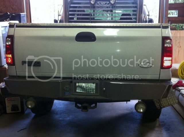

Pretty straight forward.
