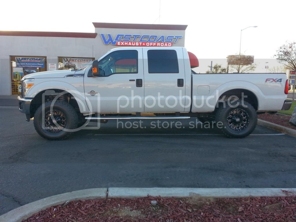

That's exactly what I did. Got the Rough Country lift with 3" coils in the front and 2" block in the back. Running 325/65R18's on 18x9 wheels with 0 offset. I am really happy with the ride better than the stock setup with FX4 package for sure. Next up are Amp steps and rear airbags for when I hook up the 5th wheel.
