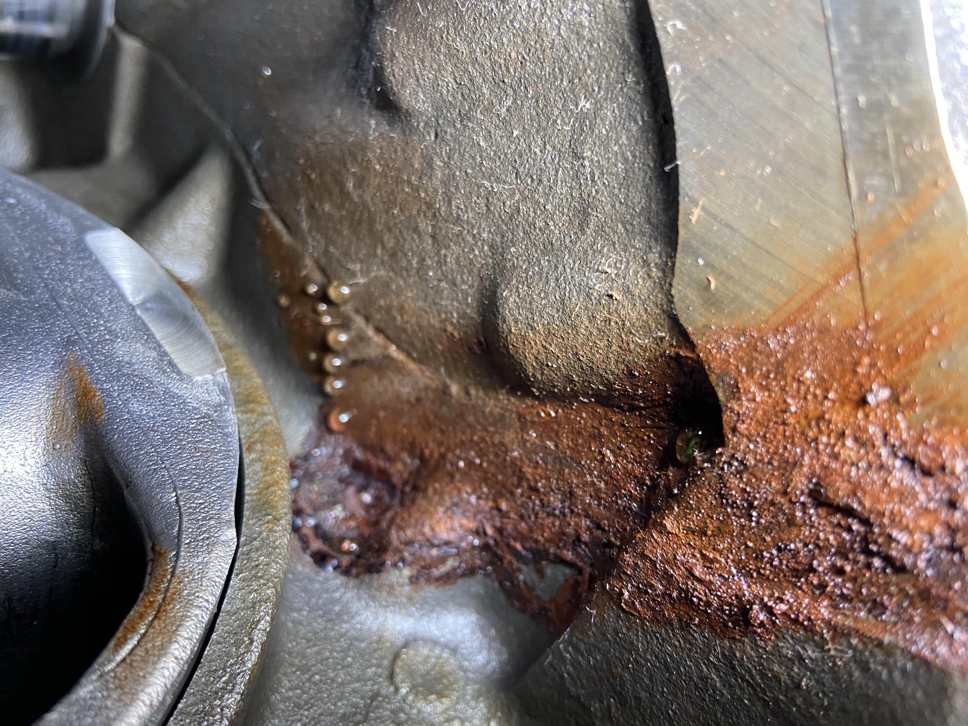

I am in the process of replacing the motor in my 95 F-Superduty . I pulled the motor because I was getting water in the oil . After checking everthing that I could while the engine was in the truck i decided to pull the engine . After I got the engine out I pulled the pan and saw this IMG_0143 (1).jpg . The motor was a jasper rebuild so I called them with the serial number but they said it must be more than 10 years old , they don't keep records older than that . I bought a used motor out of a 97 that the seller said had 150k on it . I don't know how many miles are on the bad jasper motor but everything is alot cleaner on it than the replacement motor . So I am wanting to switch the turbo , fuel filter housing , HPOP , up-pipes and oil pan over to the good motor . I have all new gaskets and o-rings for the turbo and pedestal , up-pipes ,
