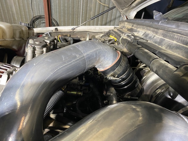

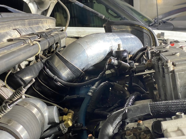

Just in case anyone else comes across this issue where the turbo won't line up with the CAC piping as mine did. I noticed that the Riffraff plenums are a slightly shorter than the oem plenums. So I figured this should help with the alignment issue, and since I had my turbo removed I took the time to shave off rest of the area on the turbo cover that was hitting on the Y Pipe. So the combination of the 2 worked out nicely and the CAC pipe to Turbo are now almost straight on.
On Edit; This is before the Riffraff plenums, and before I had also completed the removal of the raised nub on the turbo cover. You can see how misaligned the 2 were in this photo..
Countrycar
Jul 27, 2013
248
Texas
You can see in the photos the difference in height between the OEM plenums and the Riffraff plenums, this allowed for the Y pipe to sit lower as well. In the picture of the turbo cover you can see where I started to remove the raised area on the cover. I did this months ago back when I installed the turbo. This time since I had the turbo out, I went ahead and completely removed the raised area. This is turn helped to allow for further turbo cover rotation. I need to readjust the clamp, but the alignment is much better.
