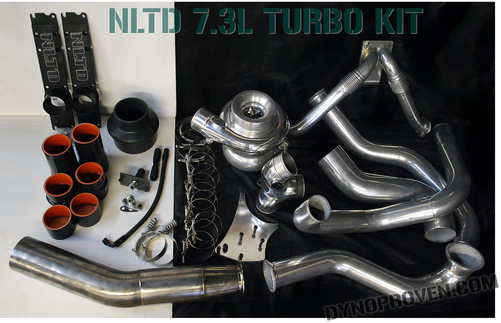

Just some food for thought for those about to start an upgrade similar to the OP's..............

The kit can be broken up into individual components but the entire kit w/ turbo is gonna ballpark around 4000.00. Pensils are getting sharpened right now so it will prob. come in a little bit cheaper but figure on a 4k worst case tag.
Swaan
Mar 19, 2012
734
That's a very very nice looking compleat kit!! I like the two piece down pipe. Nice touch!!
