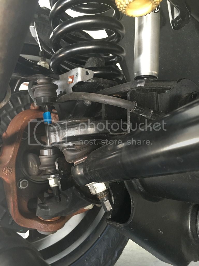

correct. and i just noticed i was looking at my factory sway bar in the front and saw the driver side end link pretty stretched and the passenger side straight is this normal
Mine were all jacked up at first. PMF drop brackets fixed the stock bar but when I switched to a Hellwig Big Wig front bar I had to remove the drop brackets since it was making contact with something....can't remember what. Removed those and everything is back in place. Must be some differences in the bends between stock and Hellwig.

Do you know if leaving the stock sway bar and having the driver side one at a pretty harsh angle hurt anything?
Mines like that also. Not sure why
So did the hellwig bar also straighten up the end link angles even after removing the drop brackets?

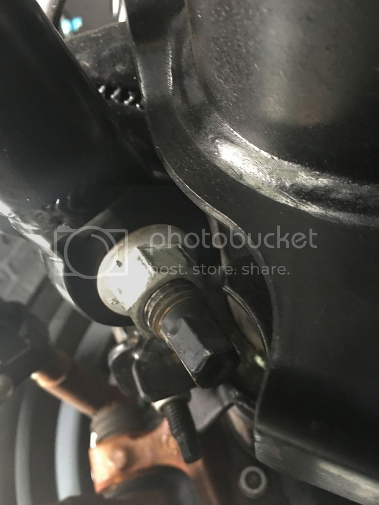

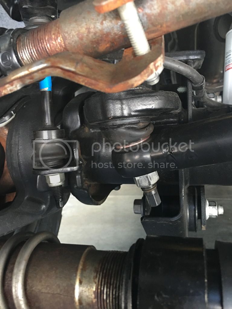

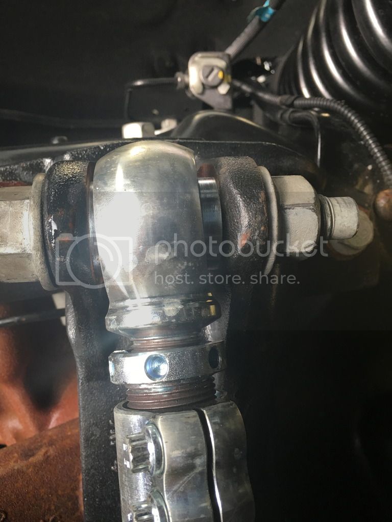

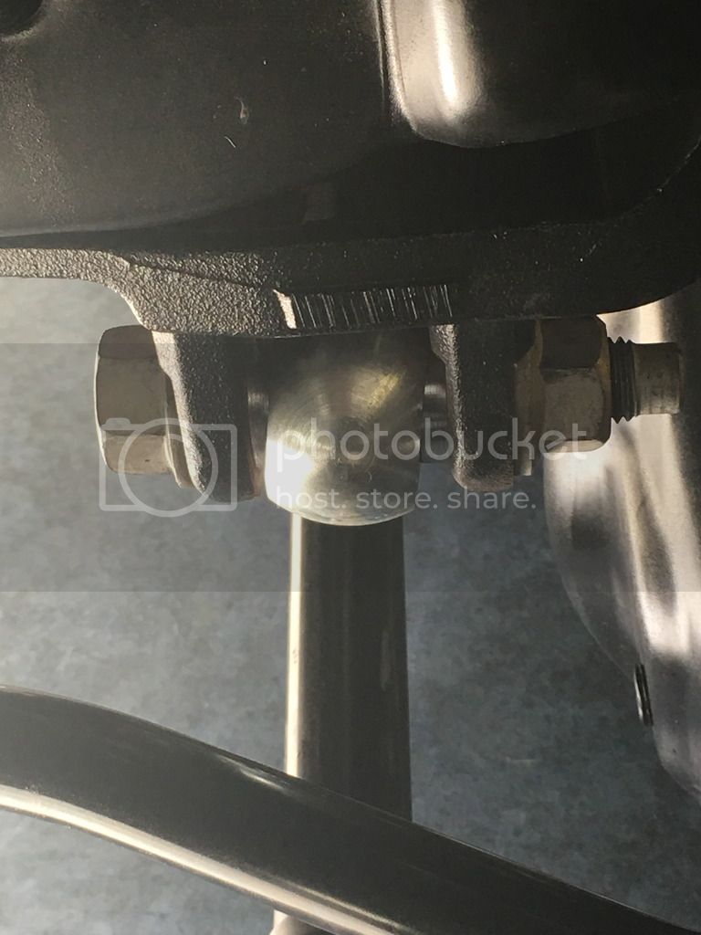

hey guys I've noticed a thud noise if you would call it when turning my trucks a 2015 2.5in icon coils, pmf 3 link, 4in block, i re tightened the ubolts, wheels, went over everything and only thing i found was the heim joint on the 3link the nut was loose and the join was cockeyed so i straightened back out and tightened the nut back but noticed on the icon track bar was cockeyed and on the passenger side is pretty steep angle almost hitting the axle can anyone verify that everything looks ok
I just happened to check mine out yesterday morning and my track bar was in the same position against the axle. I got to messing with it, and found that one side of the collar that joins the heim to the bar itself was somewhat loose. You might check yours and make sure they are still tight. I've got the Icon adjustable bar as well.
