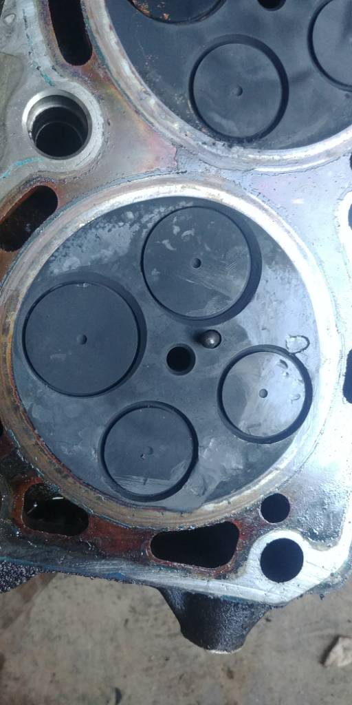

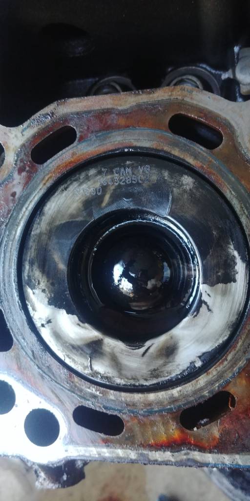

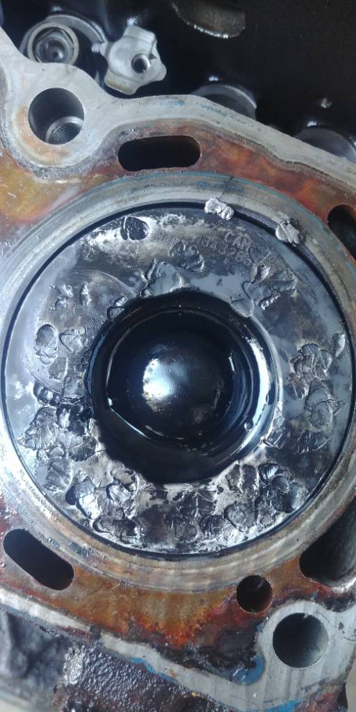

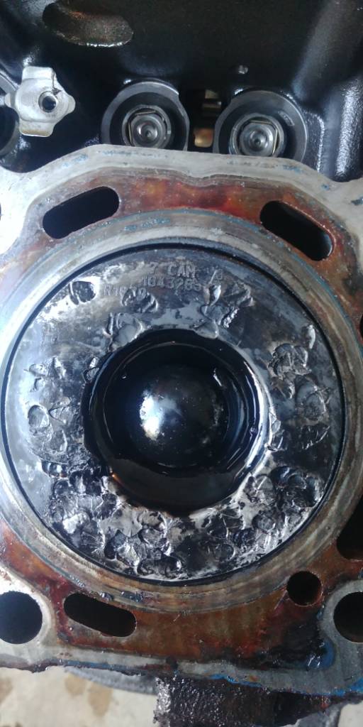

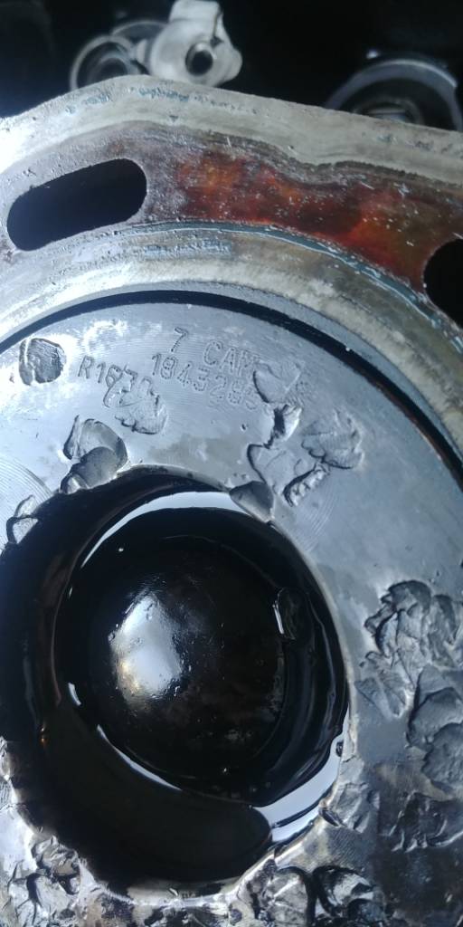

Well, I got it torn out finally. It's definitely NOT what we thought... Turns out the valves kissed the pistons. The lifters look fine, the cam looks good. I don't know what the metal flakes came from yet, so that's a little odd.
Cylinder 6&8 both have valve marks. Cylinder 8 has massive piston damage from something getting in there and bouncing around. It ran fine until it didn't, and when it was missing, cylinder 6 was the only one low.
Any idea what the heck is going on here?
Sent from my LG-H872 using Tapatalk

I wish your pictures were better.
Nothing is embedded into piston or head? Maybe check 8n exhaust manifold, turbo, down pipe, etc for the piece?

I can't tell what is in cyl 8. That's not the cyl that was showing a miss though, that's what's messing with me. There's no damage in the turbo, so whatever it was has to be stuck in the piston. I'll check it out better and try to get better pictures tomorrow.

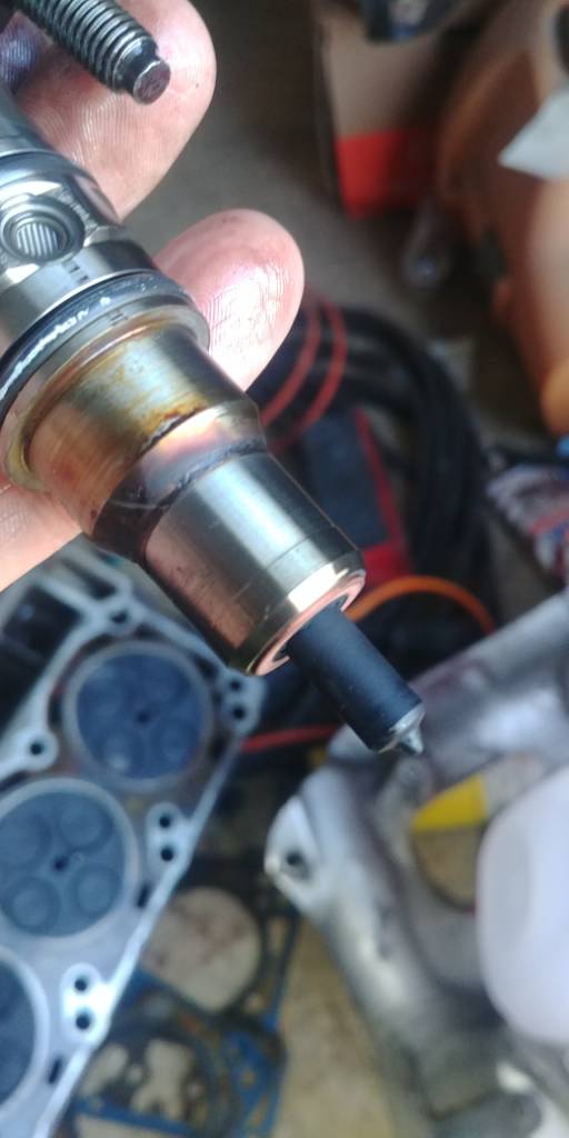

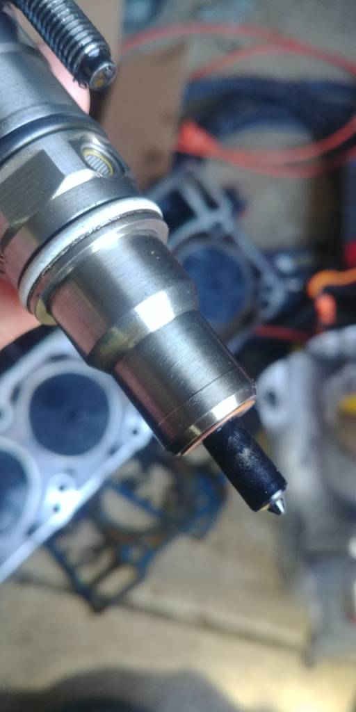

Broken glow plug?
Look at the head pictures. All intact. I can't tell what it is, I'm going to check it with a magnet to see what it is, but I'd guess aluminum of some sort because it's smashed so flat.

In the picture of what i assume is #8 head, it looks like part of one of the intake valves broke off? Is that me seeing goofy chit, or does it actually look like that?
Outside intake valve at 12o clock.
