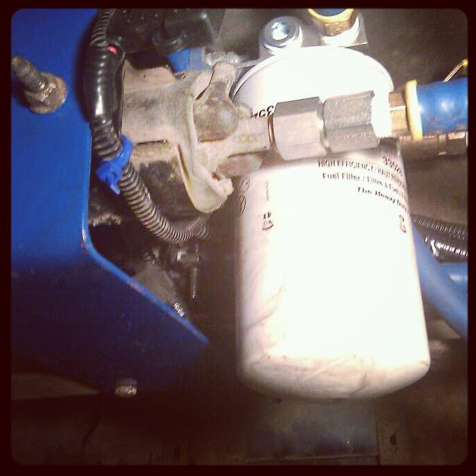

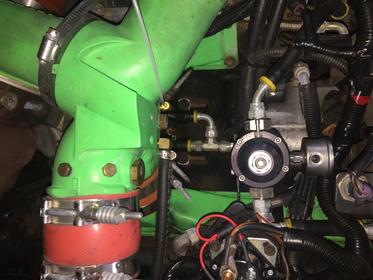

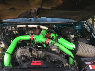

Couple pics of pump and filtration setups I've built. Got three trucks, they are all basically the same. More than 250$, but its built using stainless fittings, and on one, dual pumps. Rock solid on three trucks for over 300k.
Pre and post pump filters, and a regulated return of your choice.

Where did you get that bracket?
