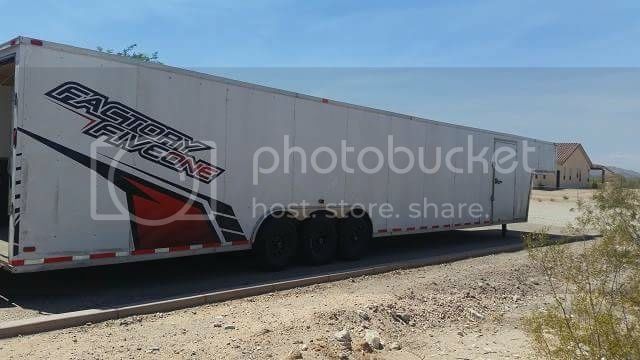

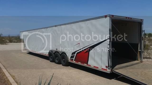

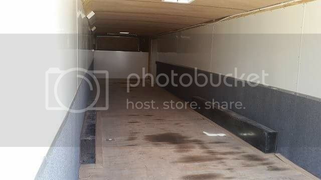

going to pick it up today so will let you know how it goes, got a B&W hitch installed yesterday so we will see how it goes, gonna for sure get new tires here before i load it with anything, But yes my payload is low compared to how some would use this trailer, even with 3 cars in the trailer, along with all my tools, tires, fuel, ect im maybe pushing 6K minus trailer weight.
JRLott
Feb 28, 2015
1,456
4
TX
Definitely need pics. What tires are on your truck now? If they're still in good shape and adequate rating...
89 Stroker
Feb 3, 2013
1,317
Southern Cali
whatever the truck came with from the factory is what is still on it can't remember the brand but I think they had a 3100 pound load rating, I could be wrong.
Here are a few pictures they sent me of it, has interior lights , roof vents , also piped to hook a compressor up to it, new tires and brakes, supposedly they people used it ounce to move from Kentucky to Arizona and that's all they bought it for, it's a 2013 diamond. Will get better ones in the am when it's hooked to the truck
JRLott
Feb 28, 2015
1,456
4
TX
Oooo....3100...that sucks.
Damn nice trailer. Watch your tail swing.
