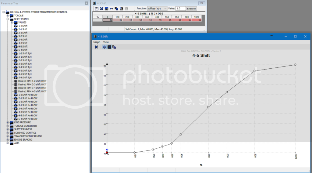

this is the only pic I have at the moment. As you can see I have the shift point rise with throttle position. Also the "mph" values for the shift points are off by a certain factor for some reason, so dont worry about the actaul value, its more about how they compare to the other values. For example in my truck, when I set the shift point at 50 in the tune it really happens at 60ish, and when I set the shift point to 25 in the tune, the truck will actually will shift at 30ish. You probably won't want to use my exact values as I have altered my throttle mapping and some other things.
