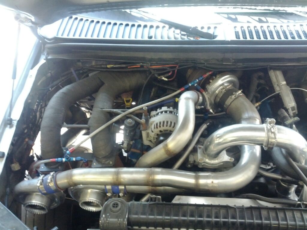

66 on the manifold and 2 80mm under it. Should be plenty of air!
Um, no. Way too big on the primaries.
2 62s and a 64 or 66 would be a good setup.
Garrett
encrypted with an enigma machine
Like already mentioned, this would never work. Those 80's would never ever ever light lol.

Thanks, that is the main reason driving this build. I want to repeat, with enough street time I should be able to find all the weak points and hopefully be successful.
So that's what you're up to:rockon:
You Cali boys are making me wish I went bigger/ could afford to lol.
Yup, that is what I am having done. Just waiting on the rods if f'ing killing me. Suppose to be shipped last week but I don't think they have. This set up is simple since we are adding the 98mm to what is currently there. WG's will be a little more complex, but Mike's build is leading the way.

Heard yesterday they shipped, finally! Just have to get it all balanced and then put together. They have everything sitting with the cab up waiting, so I am hoping by fuel fest it will be ready. But I am not saying that out loud.

We are definitely going about it differently. Yours should work great, proven set up. I will be running 150's.

Not exactly a proven set up on a 6.4. But has definitely made good results on dmax's and cummins. So one could assume nothing less then.

True, it is all new on a 6.4 but I figure since they work great on the other brands it should carry over....hopefully. We were talking about running 110's and ramping up the pw, but I would rather have enough fuel and pull some away if needed.
