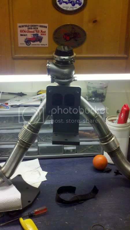

It is just fab and machine work after all. Need a heavy plate to bolt in the valley, machine it flat, cut o ring grooves, then the exh wye, T4 flange and up pipes, drain tube and oil inlet, your done.
Got a mock up motor?

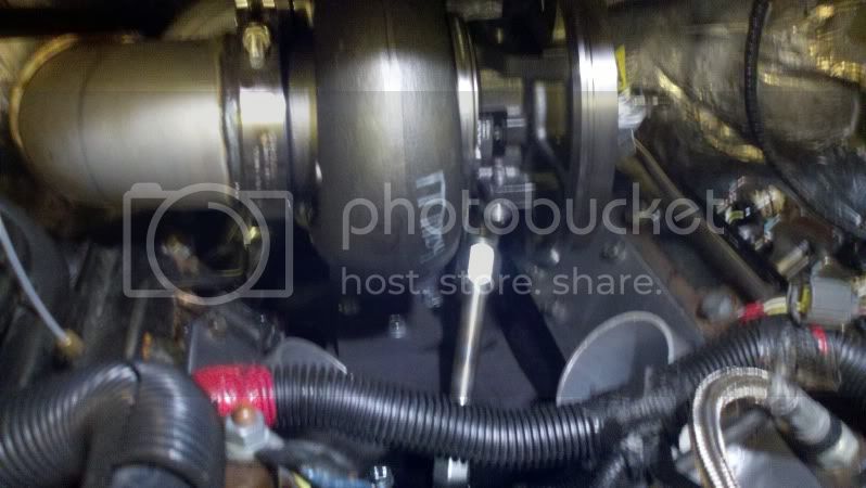

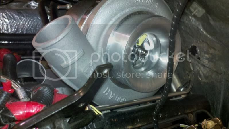

Alright I think I can fab it all up... My main question now from looking at the turbo is this... Where do I get the oil supply from? Do I get it from the old pedestal or like the HPx crossover?
I can only imagine the oil spray/explosion you would get out of all the turbo seals the second you started that thing up, hooked up to the HPOP rails LOL That would be something to video. Nope only LPO engine only
There is the stock location but a number of kits plug that and go with the one right in the middle of the valley.
