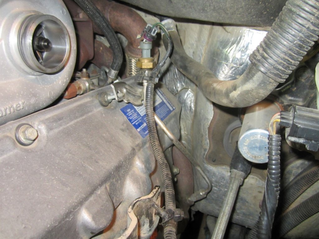

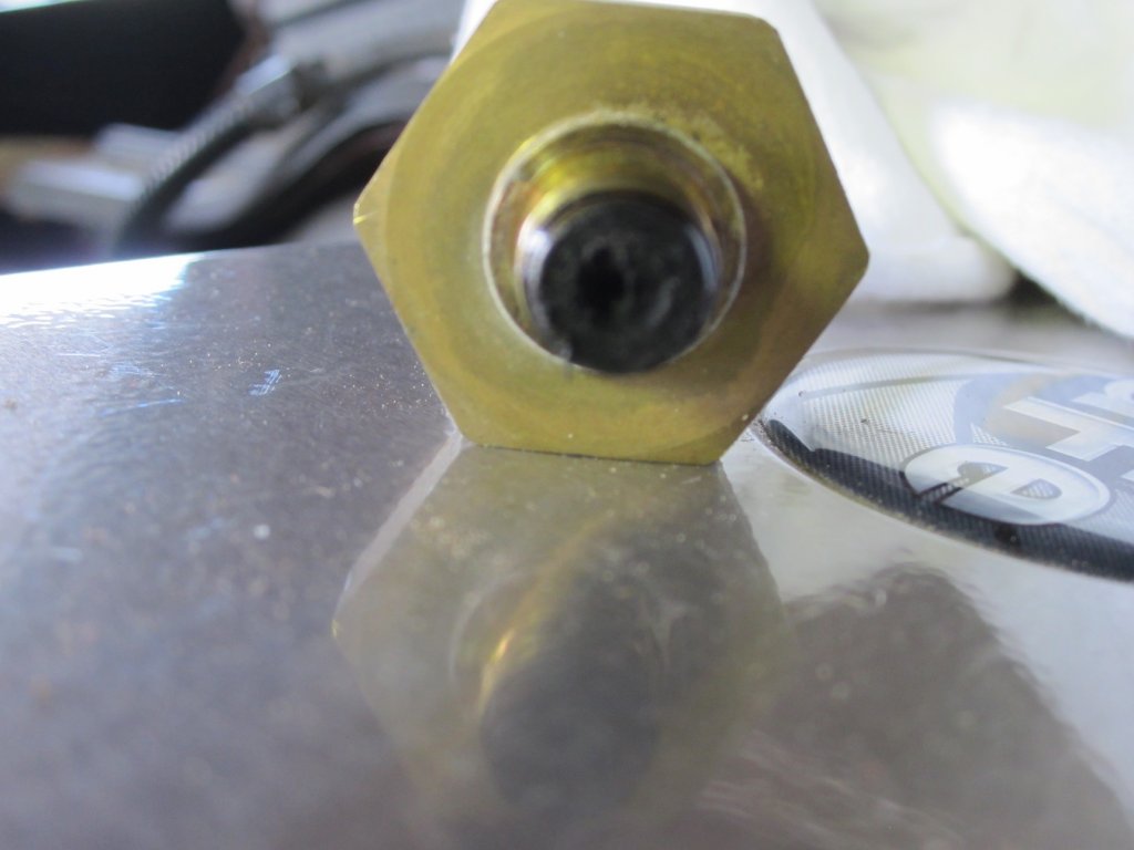

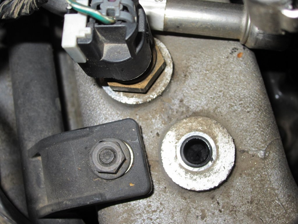

Before replacing the VGT actuator, check that the MAP sensor & the exhaust pressure sensor (back pressure) are reading correctly. Ensure the MAP sensor & port in the Manifold are not plugged up. Same for the tube & fitting that connect to the EP sensor to the exhaust manifold.
I have replaced the EP sensor and tube with brand new ones, cleaned MAP and port and cleaned MAF last night.
