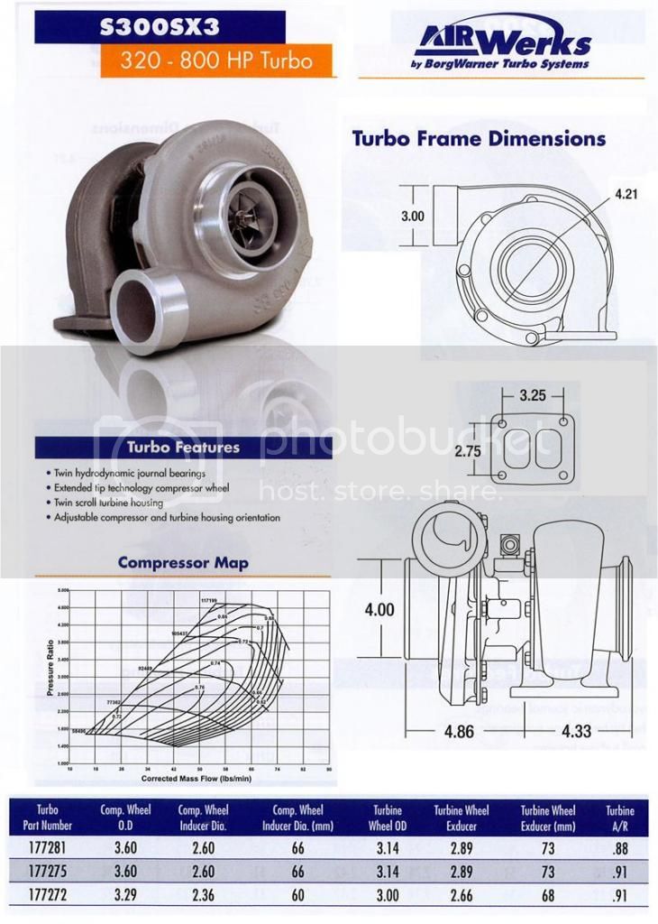

What is comparable to a 38R with this mount? Have 160cc injectors, don't know if I want to buy up-pipes, pedistool, and 38R.
not in the least.
(edit)..if you're at high altitude, you might consider a 62mm
http://swampsdiesel.com/prestashop/.../1158-s362-high-elevation-or-under-400hp.html
mattman347 and I both ran an S468FMW on the Full Force Stage II's (160cc/100%) and it wasn't that bad at all. He had better luck than me, but I was really happy. My 3:73's and 37's made it a little laggy at first, but soon as it lit, man was it nice. EGT's stayed low and power was made.
Any FMW turbo does good with spool up and flow, just size the housing for the injectors you are running.
