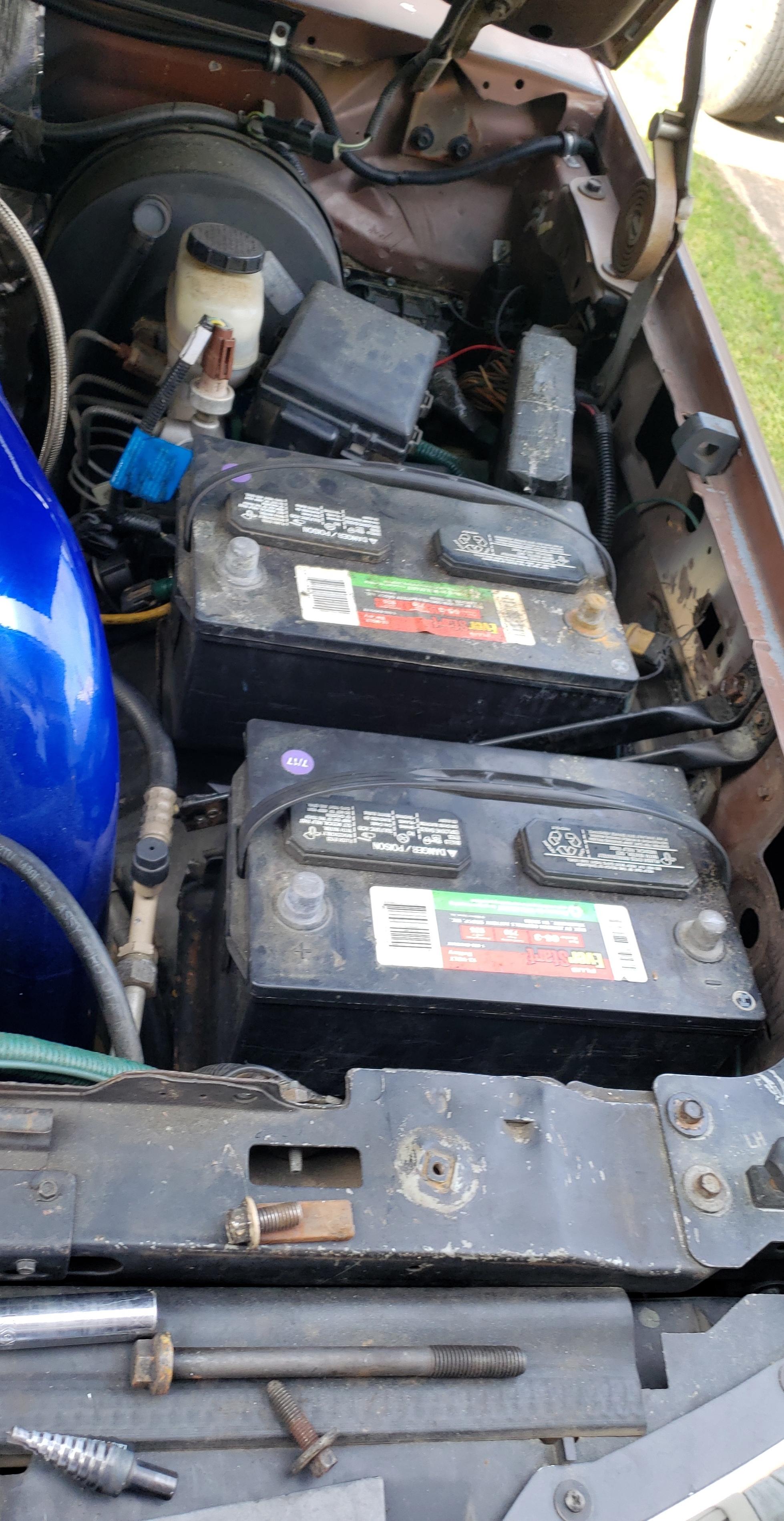

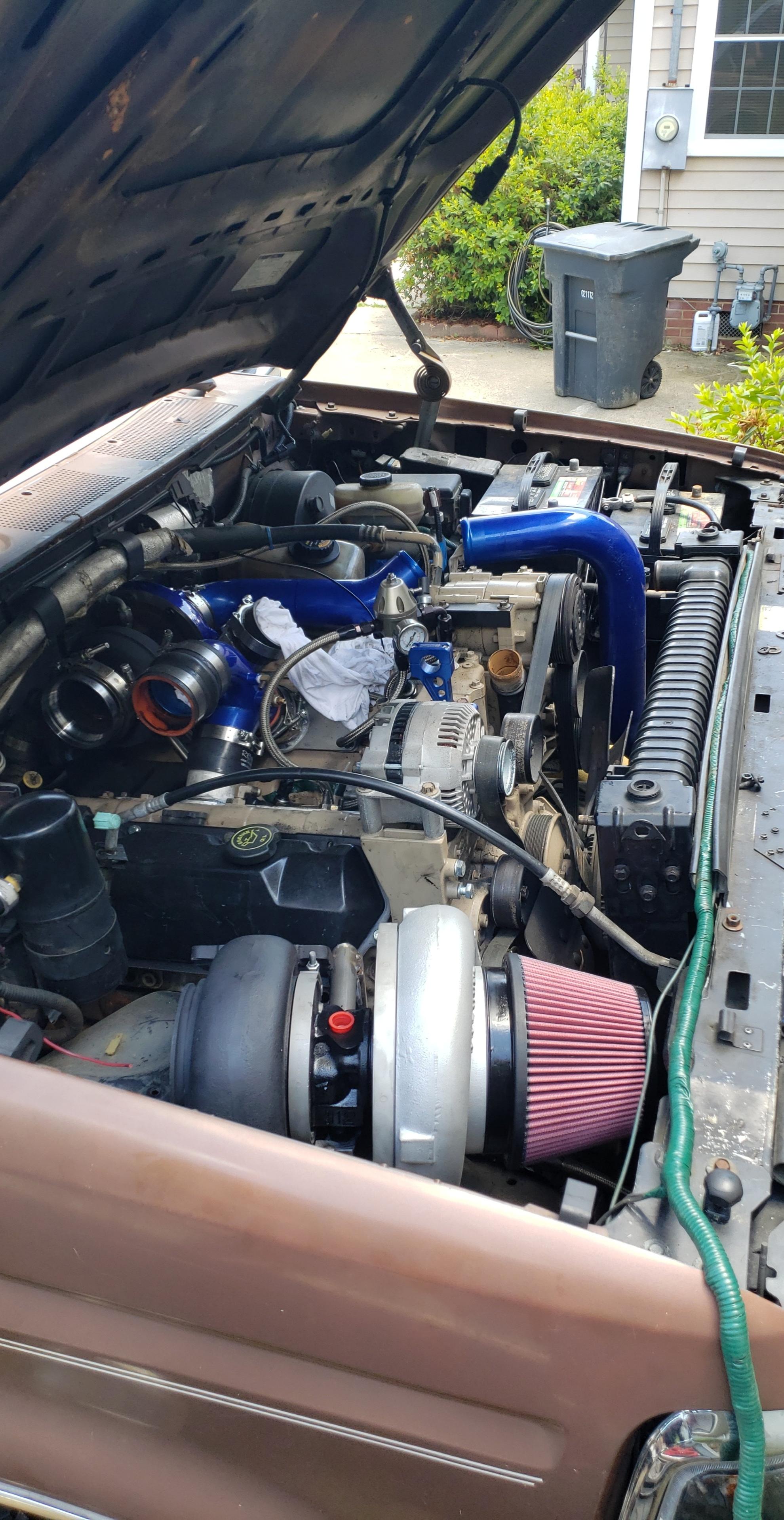

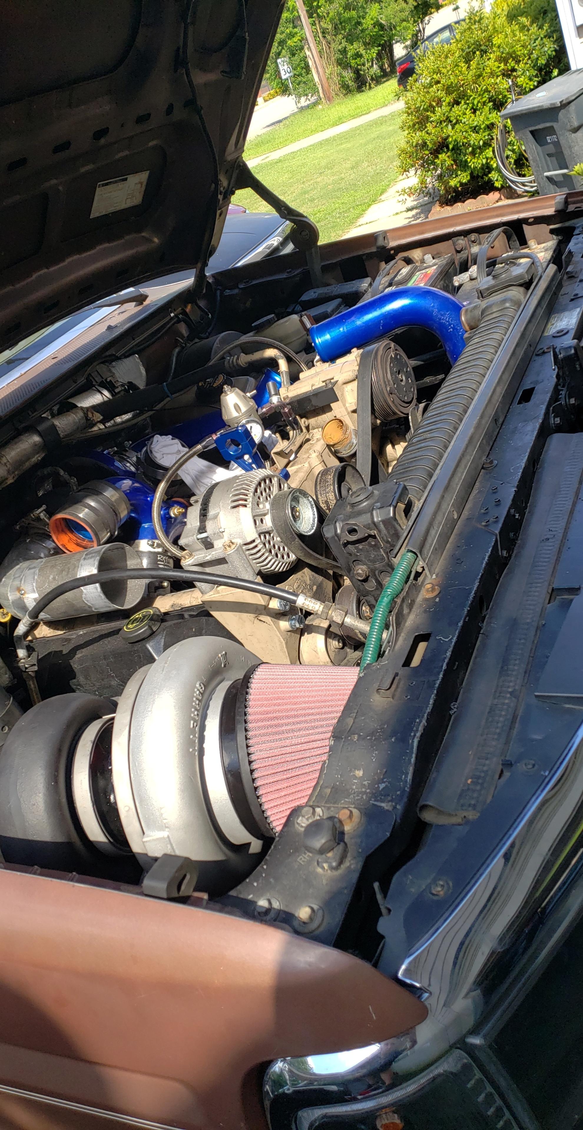

Well I got the turbo in where I want it and tacked into place, ended up using some 1 1/8 dom tubing and an awesome tubular turbo mount from maven performance. Originally I assumed the turbo was a mid frame Garrett but turns out it's actually a large frame and takes up a decent amount of real estate under the hood, also I relocated the passenger side battery to the driver's side of the engine bay and I really like the way it turned out! I also had the turbo modified to have a v band discharge and a boost reference port added.
