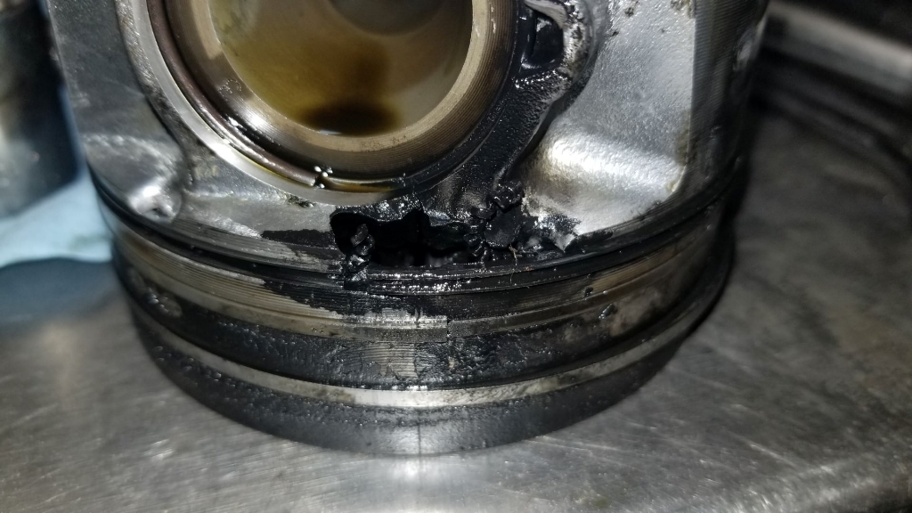

Looking at the erosion on that piston, I would not be reusing your injectors unless they are 100% gone through or completely replaced.
Roccafellas
May 7, 2017
357
The combination of too much fuel or too little air will have the same result – thermal growth or piston crown erosion. This can be attributed to clogged air intakes, restricted exhaust, malfunctioning turbo, incorrect fuel pump calibration, injector contamination, and of course, injection or engine timing.
I had a clogged intake and clogged cat. I had no prior issues of a bad or leaking injectors no smoke, no knock it ran perfect. Until I stepped on it, and it just choked and died.

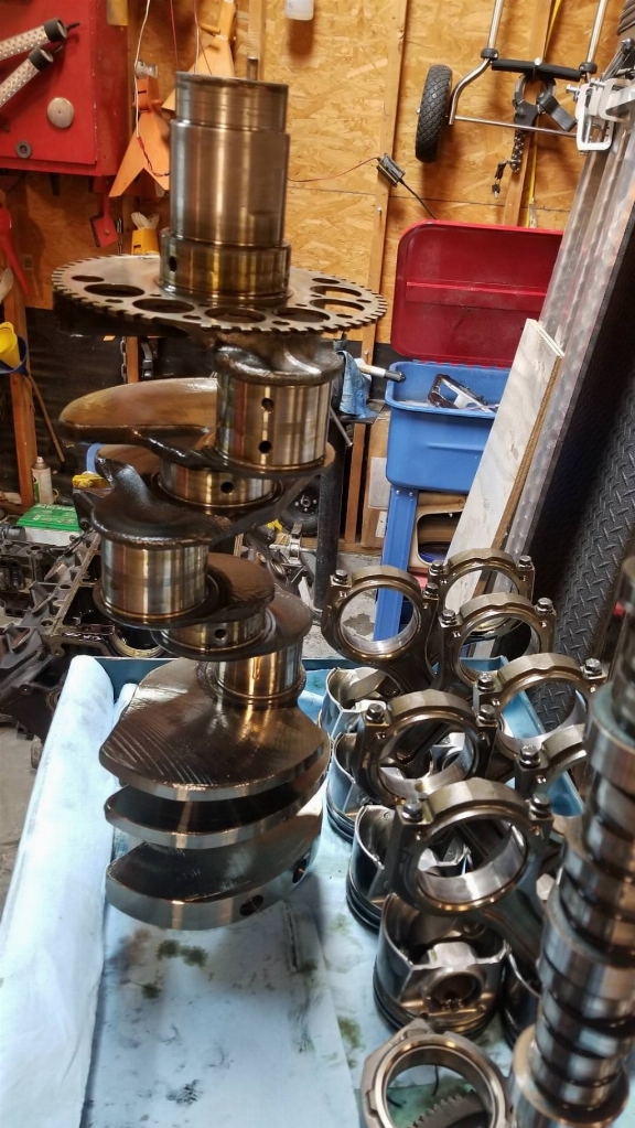

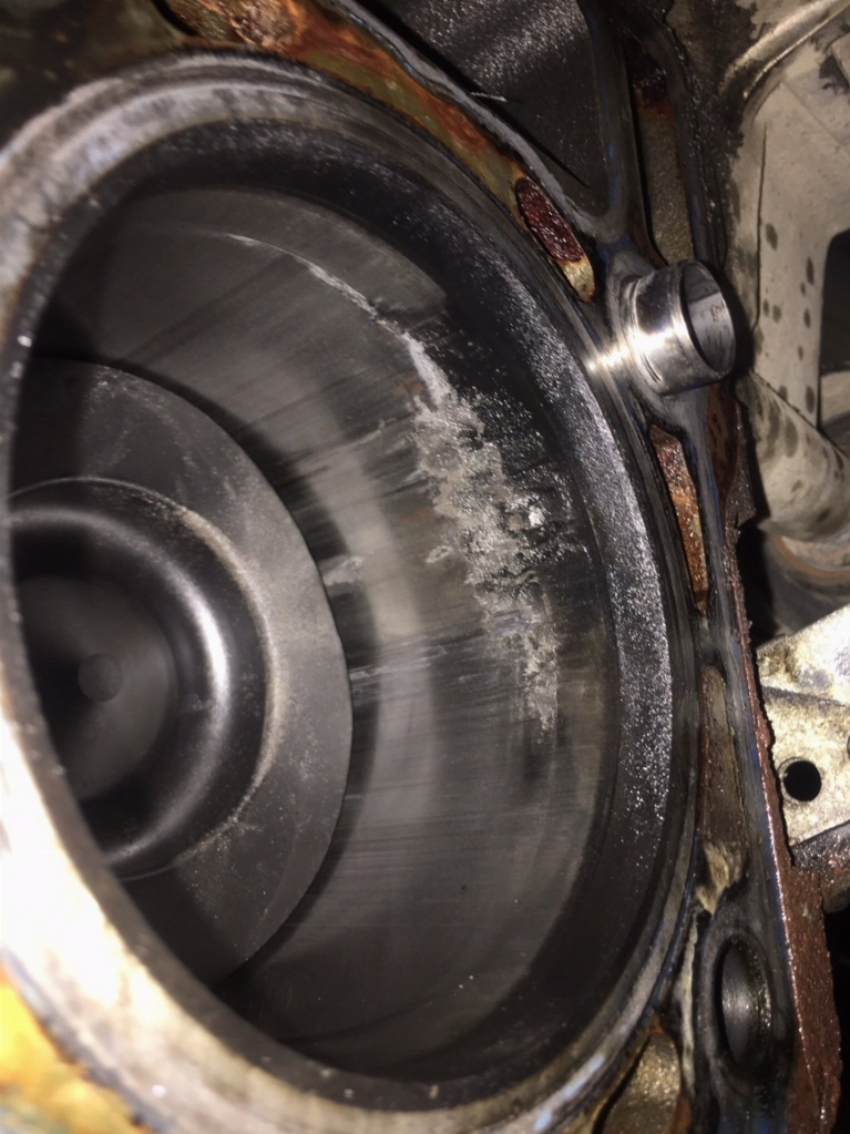

On the way to the machine shop to see what all is needed.
Hole all the way through.
Everything out. The crank looks really good, but i'll have it polished anyway.

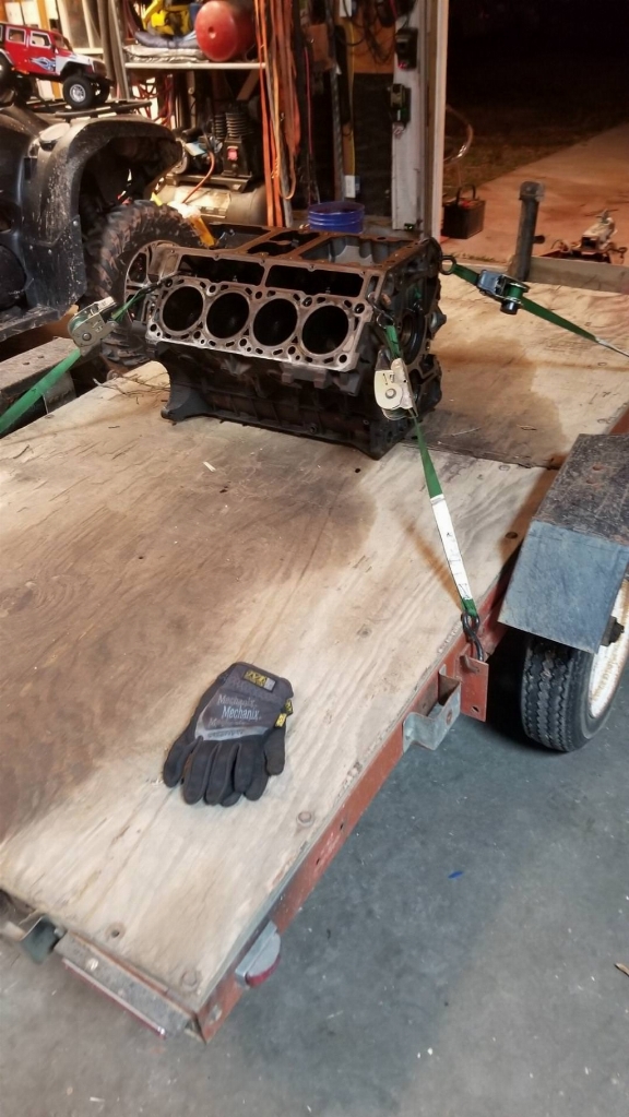

On the trailer ready for the machine shop.

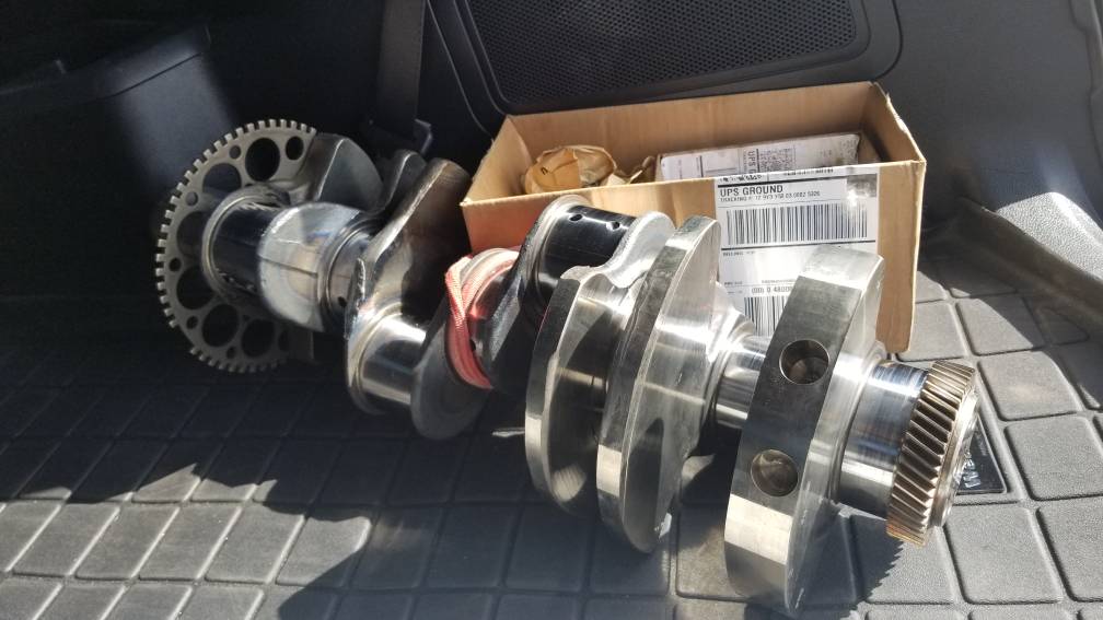

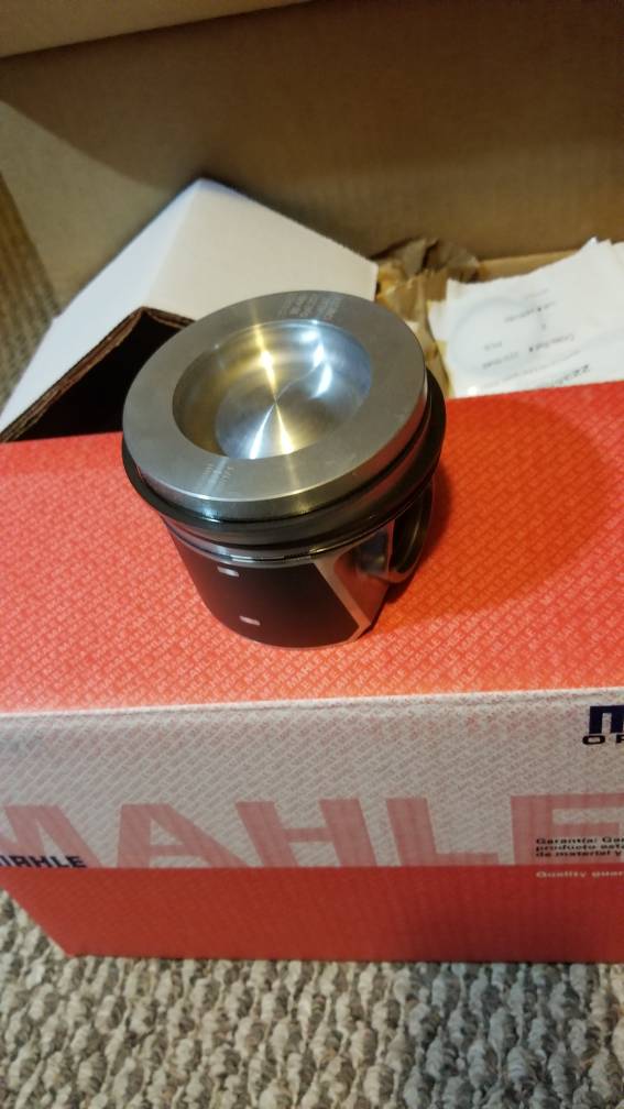

Long story short, my block was too far gone. Bought a used motor in hopes of a usable block, but it was worse than mine. Found a good block from another forum member and had it shipped here. Machine shop took forever, but finally got to it. .020 over pistons and stage 1 cam showed up today and will be taken to the machine shop tomorrow. I hope they are faster at this last part so I can get it back. I've been down since october...

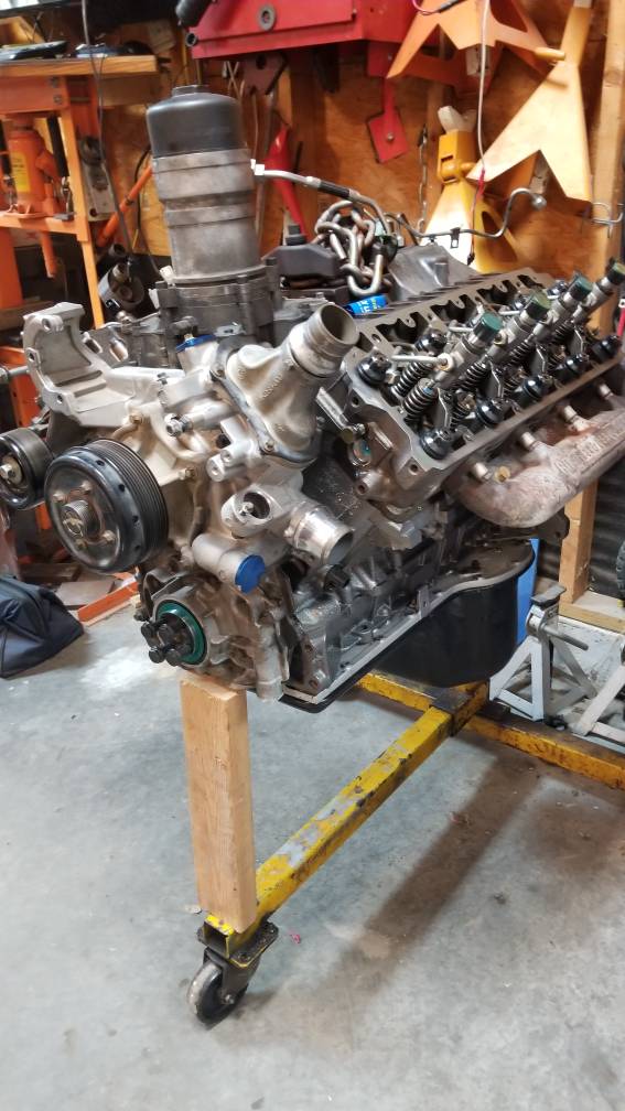

Picked up the block Friday and spent the weekend assembling. Didn't get the rear seal from the dealer and ran short on lube for the studs so I didn't get it back on the chassis yet, but it's close. Sure feels good to finally be going back together.
Sent from my SM-G950U using Tapatalk
Shafer171
May 15, 2016
495
3
Michigan
Looking good. Glad to see I'm not the only one using a 2x to help my engine stand. Those Damn thing are heavy aren't they!
