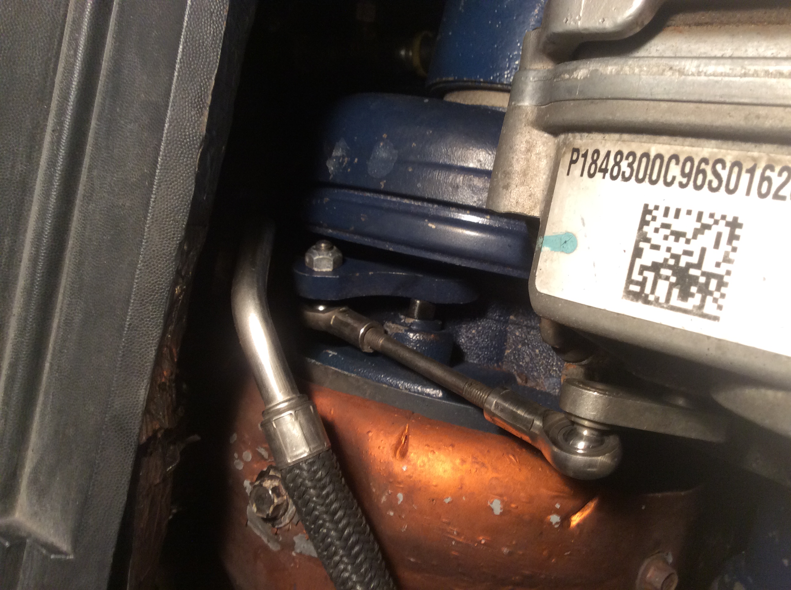

I got a p132b and p2263 codes today, popped the hood to find this. Pressed it back on with a screwdriver we will see if it stays. These are pressed on are they not? Also got my isspro gauges wired up tonight but looks like I may have a bad sender for my boost gauge, it reads 10 psi with the engine not running.

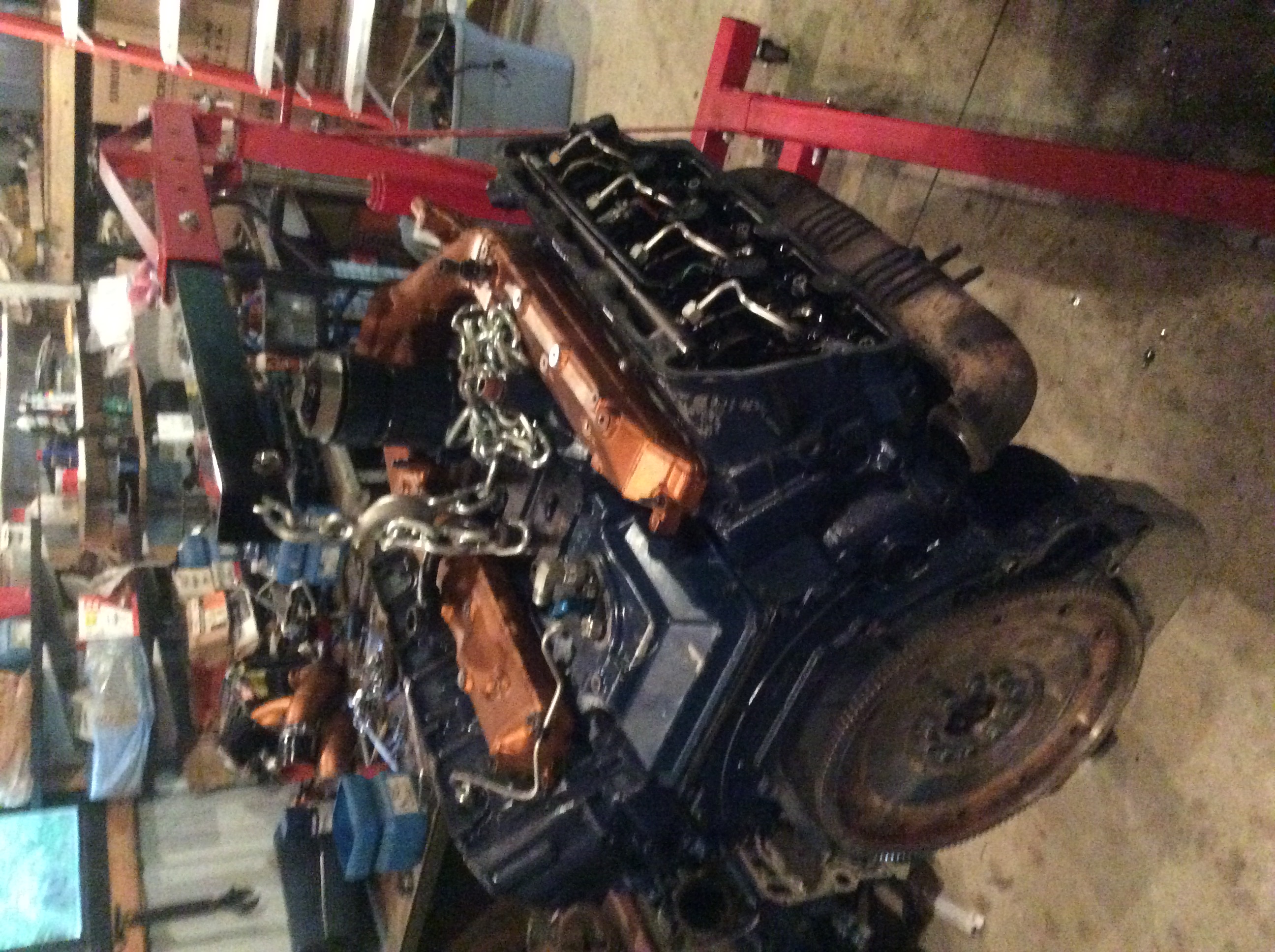

Ready to pull. New block will be ready for pickup his week. All assembly will be done by me this time.
