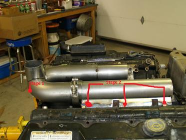

Here is my question. Now that I know what my intake is going to look like, its time to figure out where to place my water injection nozzles. I am thinking of using 2 stages, 1st stage will have 2 nozzles, and the 2nd stage will have 6 nozzles.
on each side. 1 at the rear of the intake, and 3 running the length of the intake opening on the head.
